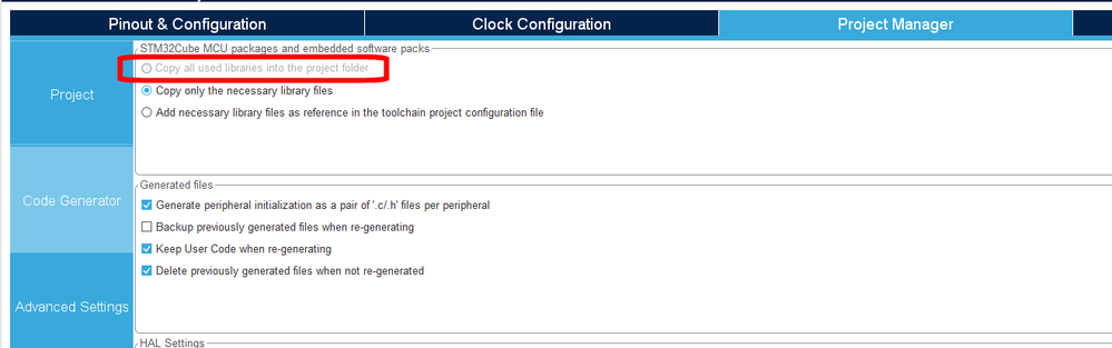

‎2024-09-24 6:35 AM
Do you have this option checked?
If so, try un-checking it?
‎2024-09-24 6:50 AM

‎2024-09-24 8:51 AM
Thanks for your suggestion. I already disabled this option.
The adc.c and adc.h files are not deleted due to this checkbox. But unfortunately the necessary HAL drivers are removed when generating the code.

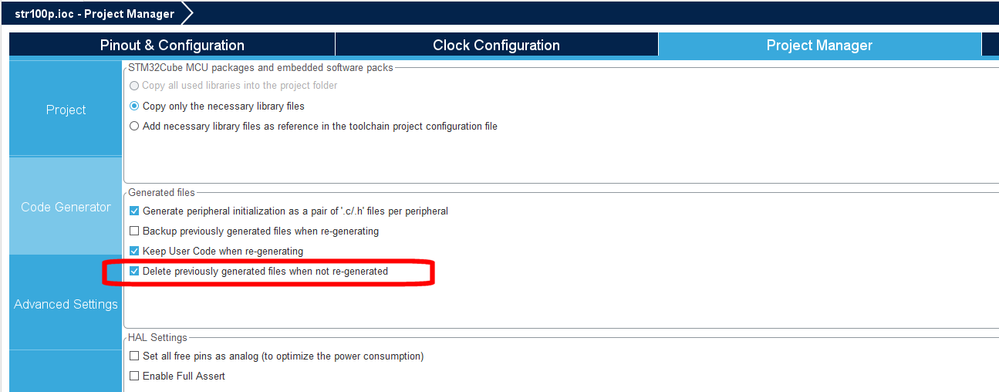

‎2024-09-24 10:07 AM
Ah, right - so would this option help:
The wording seems a bit strange, so not sure
