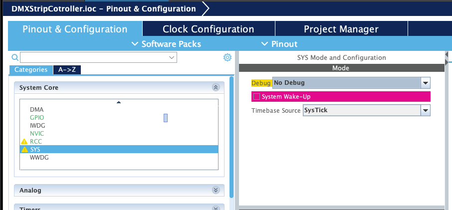

    OK Found it!
    Somehow I have set debug to "No Debug" - Must have been me, but I don't recall ever going there!
    Changing ti back to Serial Wire debug fixes it.

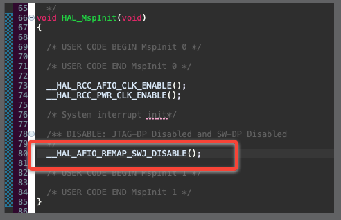

    If I step into HAL_Init() it stops at this line:

    My IOC file has reserved the pins for debug:
    Look at the comment immediately above that line: you are disabling the JTAG and SWD - so obviously the debug connection will fail!
