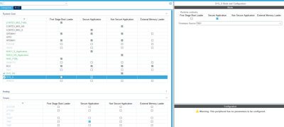

- I would also like to report another problem I’ve encountered: under sys_s / sys_ns in CubeMX, I’m unable to select any timer for the Timebase Source — neither SysTick nor None are selectable. Even if i enabled the ThreadX and Ethernet, and some more Peripherals.

‎2025-05-22 3:29 AM
Hello @SITARAM ,
The same topic was discussed in this Post. An internal ticket 208214 has been submitted to the dedicated team for fix.
For the second question and in order to enable the Time base source in the secure context as TIM1, you should activate it in the same context.
I will be waiting for your feedback.
Thanks.
