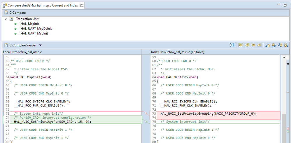

Issue is:

2020-07-28 5:14 AM
@Nesrine.JLASSI I confirm @Daniel Mårtensson issue using NUCLEO-F401RE board.
Relying on NUCLEO-F413ZH all is fine ...

2020-07-29 2:46 AM
Hello @Daniel Mårtensson
Thanks for the feedback, issue reported to the tool development team that will plan the correction.
Best regards,
Nesrine
2020-07-29 3:14 AM
2020-07-30 8:02 AM
A new STM32CubeMX release will delivered to correct this issue as soon as possible.
