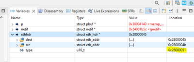

Cuold be insufficient stack size.
Look at the ethhdr pointer and ensure it's valid. If it's not, set up a hardware watchpoint to see where and when it's changed.

Yes @TDK I watch the address: is 0x28000045
and ethhdr->type is 0x24001b64

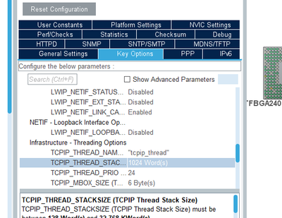

how to increase stack size for tcpip_thread ? maybe TCPIP_THREAD_STACKSIZE ?

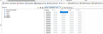

it seems msg->msg.inp.p point to invalid address: 0x28 ...
No RAM @ 0x28...

Apr 30, 2025 2:48 PM UTC

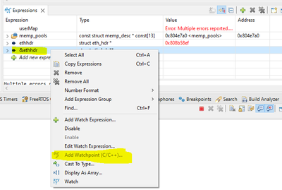

Here's how to set a watchpoint:
https://community.st.com/t5/stm32cubeide-mcus/how-to-add-the-watchpoint/m-p/310217/highlight/true#M16720
You want to watch for the pointer to change, so add &ethhdr as the expression.
MauFanGilaMedical
May 5, 2025 6:06 AM UTC
Watchpoint is disabled maybe ethhdr is a local variable

Have you increase the stack size from STM32CubeMX as you show on one of your messages ?

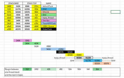

When I go to HardFault I shot the stack and see if one thread stack overlap the next but I don't see this situation

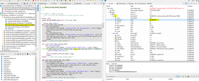

Today it goes to HardFault from __ISB or __DSB:
Stack for __DSB
And stack for __ISB
If could be helpful the CFRS is IMPRECISERR

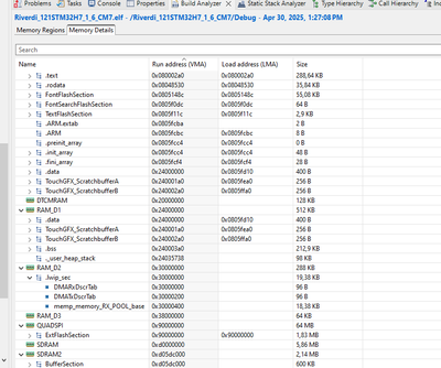

May 12, 2025 9:57 AM UTC

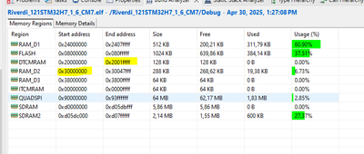

I observe that memp_memory_RX_POOL_base is at 0x30000400 and its size is 18,38KB, so memp_memory_RX_POOL_base spans in 0x30000400..30004BCC.
Starting from this I set LWIP_RAM_HEAP_POINTER to 0x30005000 because I suspect that memp_memory_RX_POOL_base overlaps LWIP_RAM_HEAP_POINTER.

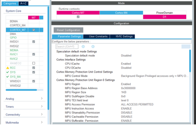

Then I go to MPU and increase MPU Region 1 Size from 16K to 64K because it started from 0x30000400 and its size is 0x30005000-0x30000400+14KB
Subsequently I increase INTERFACE_THREAD_STACK_SIZE from 350 to 1KB ..
And I increase that stack of Server thread from 1KB to 10KB (even if I want to undersand how to reduce it to a minimum necessary size)
With this change the Server works without MCU crash... I observed one/two crashes and I'm still investigating.
I notice that when I send packets from PC to MCU sometimes MCU crashes
