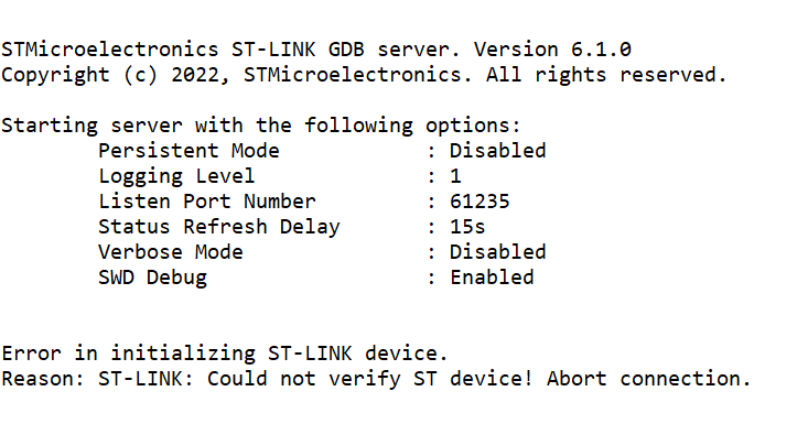

But ST-LINK: Could not verify ST device!
error details :

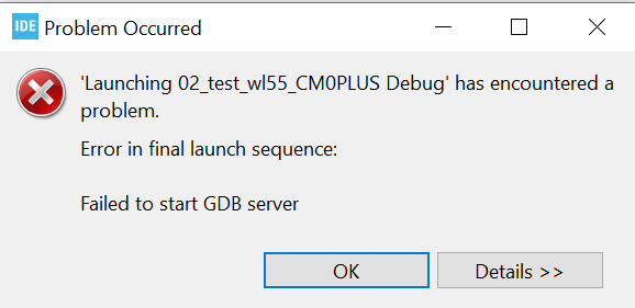

Error in final launch sequence:
Failed to start GDB server
Error in initializing ST-LINK device.
Reason: (18) Could not verify ST device! Abort connection.

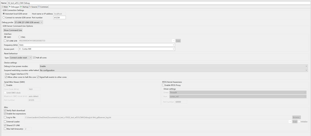

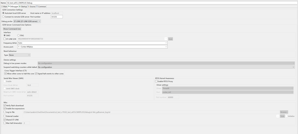

1- CM40693W00000KcGqsQAF.png 2- CM0P

here is my debug config :
CM0P :
0693W00000KcGyxQAF.pngCM4 :

The debug configs look good.
Maybe add one to the port on CM0+ debug config.
But you should download CM0+ application code with the CM4 core.
To do that, go to the startup tab (of CM4 debug) and add the CM0+ elf download.
And In the CM0+ startup tab, select the elf and edit to remove the download (keep the load symbols).
Rgds,
Laurent

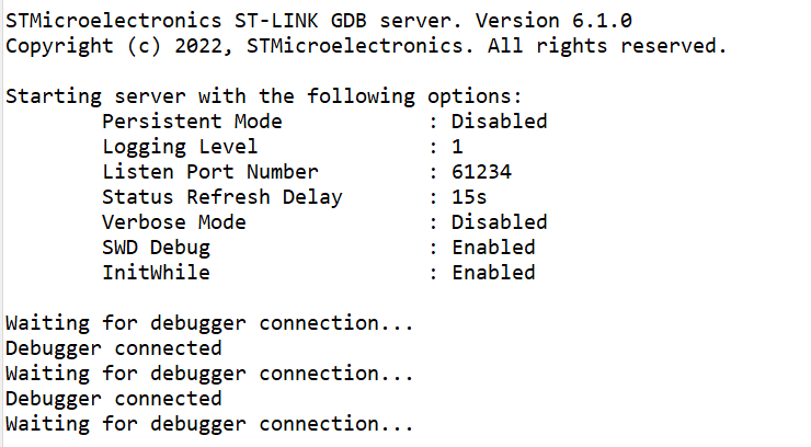

i have repeated the same staps in this video https://youtu.be/QBEfewpPTSk
when i run an application the code in CM0P is executed ...so it is work correctly but not in debug mode !
