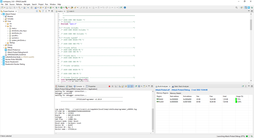

Hi all. I've got a problem when trying to flash the STM32WLE5J8I6.
I am trying to run a simple blinky code and blink an onboard LED on my custom pcb.
The program builds fine, connecting with the ST-Link (Nucleo-WL55JC1) and using SWD to connect to the STM32WLE5 works. However, when running or debugging, the program gets stuck at 97%. See picture.
The following output is seen in the console:
STMicroelectronics ST-LINK GDB server. Version 6.1.0
Copyright (c) 2022, STMicroelectronics. All rights reserved.
Starting server with the following options:
        Persistent Mode            : Disabled
        Logging Level              : 1
        Listen Port Number         : 61234
        Status Refresh Delay       : 15s
        Verbose Mode               : Disabled
        SWD Debug                  : Enabled
        InitWhile                  : Enabled
Waiting for debugger connection...
Debugger connected
Debugger connected
                       STM32CubeProgrammer v2.10.0
Log output file:   c:\users\cvan~1.aru\appdata\local\temp\stm32cubeprogrammer_a50996.log
ST-LINK SN  : 001D00083756501620303658
ST-LINK FW  : V3J9M3
Board       : NUCLEO-WL55JC
Voltage     : 3.28V
SWD freq    : 12000 KHz
Connect mode: Under Reset
Reset mode  : Hardware reset
Device ID   : 0x497
Revision ID : Rev Z
Device name : STM32WLxx
For some reason, when i terminate the console and thus the flashing, the console gets expanded to the following:
        Logging Level              : 1
        SWD Debug                  : Enabled
        InitWhile                  : Enabled
Debugger connected
Debugger connected
ST-LINK FW  : V3J9M3
Voltage     : 3.28V
Device ID   : 0x497
Revision ID : Rev Z
Flash size  : 64 KBytes
Device type : MCU
Device CPU  : Cortex-M4
BL Version  : 0xc3
Memory Programming ...
Opening and parsing file: st-link_gdb_server_a50996.srec
  File          : st-link_gdb_server_a50996.srec
  Address       : 0x08000000
Erasing internal memory sectors [0 3]
^CEncountered Error when opening C:\ST\STM32CubeIDE_1.8.0\STM32CubeIDE\plugins\com.st.stm32cube.ide.mcu.externaltools.cubeprogrammer.win32_2.0.200.202202231230\tools\bin\STM32_Programmer_CLI.exe
Error in STM32CubeProgrammer
Shutting down...
Exit.
Boot is pulled up, pulling it down makes it impossible to connect to the device using STM32CubeProgrammer.
Reset is internally pulled up. Only decoupled on the board itself.
Any hints into the right direction are highly appreciated.

Louis AUDOLY
Hello @Cvan .7​ ,
Do you have CubeProgrammer stand alone? If so, do you experience a problem with it?
If you look in C:\ST\STM32CubeIDE_1.8.0\STM32CubeIDE\plugins\com.st.stm32cube.ide.mcu.externaltools.cubeprogrammer.win32_2.0.200.202202231230\tools\bin\STM32_Programmer_CLI.exe directory, is the CLI.exe placed here ?
Best regards
Louis
Hi Louis,
First off, thanks for your help.
The ...CLI.exe is placed there.
Hello @Cvan .7​ ,
Have you the same behavior with CubeProgrammer in stand alone ?
Regards
