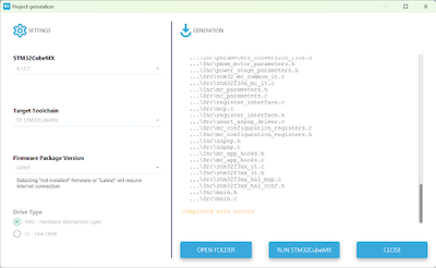

Part No:P-NUCLEO-IHM03
Version of MCSDK: 5.4.8
Tool : MC WB,MC PROFILER, P-Nucleo-IHM03

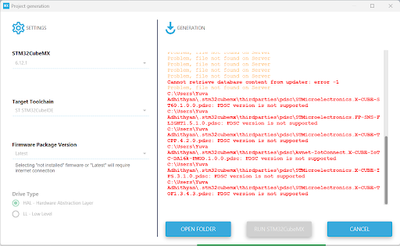

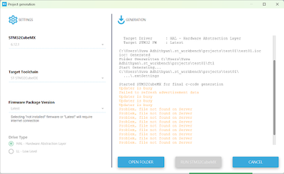

Entered code not flashed into the controller.
Here I am attached the error generated during the flashing of code.
Hello @Sravan33322,
As main.c has been generated correctly, did you try to compile the generated project?
If the compile is fine, proceed with it.
