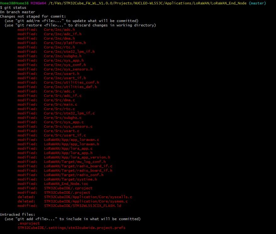

About lacking file to regenerating sample I've done some GIT based diff between original sample and generated one. Ok some delta as expected (because generated project is working) but according to me nothing is lacking ...
0693W00000BaSH6QAN.jpgOnly x2 deleted files (what you can recover) are helpers sysmem.c & syscall.c

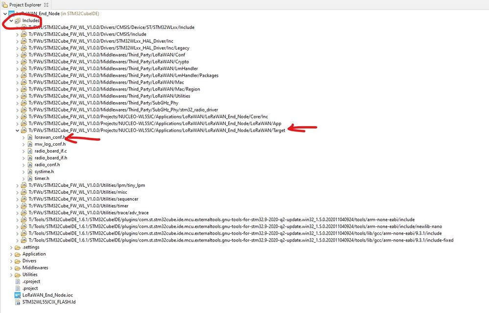

how to buils propoerly an end node lorawan application using the STM32WLE5J8I MCU but with all necessary files to configure the project BASED on the AN5406. because with the generated project using cubemx and after deleting (Core & Target & App & User & Drivers & Middlewares folders) we miss files necessary to configure the application if we want to follow the AN5406 like for example  \Projects\ \Applications\LoRaWAN\LoRaWAN_End_Node\LoRaWAN\target\lorawan_conf.h !!! lorawan_conf.h don't exist on the new arborescence
Thanks in advance
@SHATE.1​ fact is you have such files but have to get a bit of habit of some STM32Cube structure (there's couple of depending of project setup ... and yes I'm sharing your pain ...).
Discussing about lorawan_conf.h as example here it is: you've to look at includes ...
Here in fact I assume you have all AN5406  is describing but maybe at another place ...
