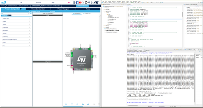

I created a project in STM32CubeMX 6.17.0 targeting the NUCLEO-G491RE and successfully generated the code. I then imported the project into STM32CubeIDE 2.1.1 and as far as I can tell it looks ok. The only apparent issue was that when I clicked on the .ioc file I thought that the STM32CubeMX project was supposed to open inside STM32CubeIDE but instead I get an error saying:

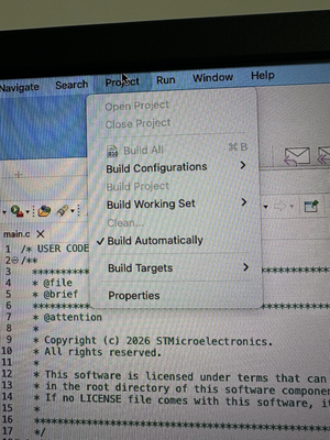

So that's one issue. But when I come to build the project in STM32CubeIDE there is no Build All (CMD+B) option available, or indeed any other build options available.

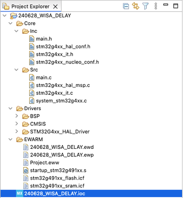

This is the folder structure:
What is missing from this workflow to create a project that can be built in STM32CubeIDE please?

You selected EWARM as an IDE in STM32CubeMX, not STM32CubeIDE.

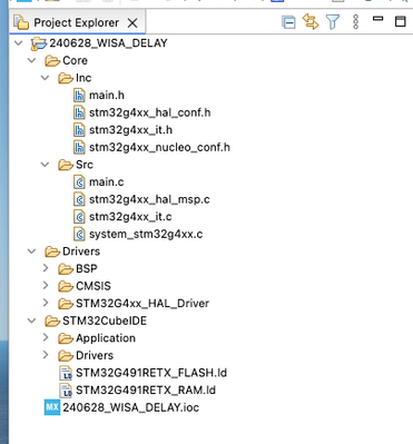

This is the difference in project structure:
Not under root:
project.ioc
.mxproject
Core/
Drivers/
STM32CubeIDE/
.project
.cproject
.settings
STM32*_FLASH.ld
under root:
project.ioc
.mxproject
Core/
Drivers/
.project
.cproject
.settings
STM32*_FLASH.ld
If you generate not under root you need to open the STM32CubeIDE folder in STM32CubeIDE, not the root folder.

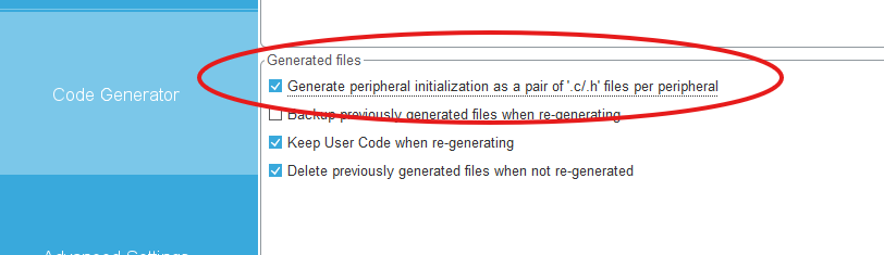

Additionally I recommend this setting:
This is easier with version control. Only peripherals that are changed will have changed files.

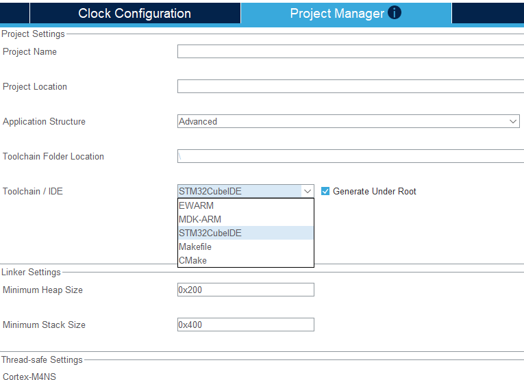

The missing Build All option usually means CubeIDE does not recognize what you imported as a valid STM32CubeIDE managed C/C++ project .The fix is to reopen the .ioc in STM32CubeMX, set Project Manager > Toolchain/IDE = STM32CubeIDE, regenerate the code, make sure the project root contains .project and .cproject files, then import it into CubeIDE using File > Import > General > Existing Projects into Workspace

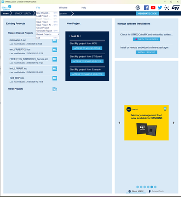

Hello @alw
Try to open the .ioc using STM32CUbeMX following those steps:
- Launch STM32CubeMX 6.17.0
- Go to File > Load Project
- Browse to the project folder
- Select the required .ioc file
- Click Open
If the project opens correctly there, you can make your hardware/configuration changes in CubeMX, then regenerate the code with Toolchain / IDE = STM32CubeIDE

I now have the project toolchain specified as STM32CubeIDE, and the folder structure looks like this when imported into STM32CubeIDE:
I still don't have the ability to build the project, what is missing from the workflow please?

Should the 'Generate Under Root' option be ticked next to the Toolchain/IDE selection in STM32CubeMX please?

For the "Generate Under Root" option, please leave it unchecked.
