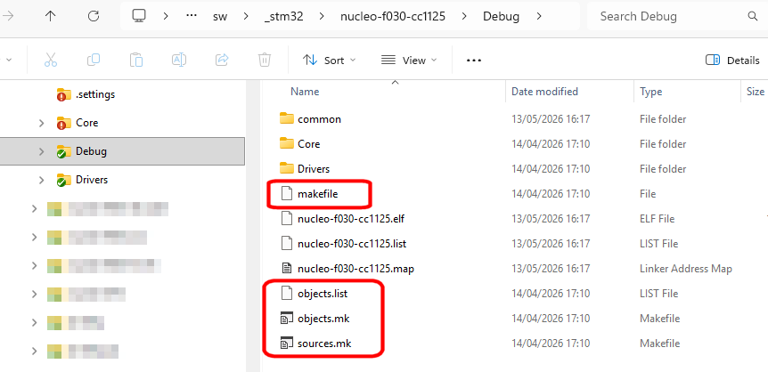

@Jim Seymour wrote:
Does STM32CubeIDE have a make utility included
Yes, it creates its own makefiles from the project - you can see them in build output folders:
Ah, yes.  I misread your earlier post.  Thanks.

Touch comes from the CubeIDE, as does the make. CubeIDE installs busybox that implements touch and many other commands used in makefiles. No cygwin is needed.
