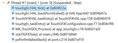

This is the stack from the point that the task locks up
Without access to the HAL source, I can't probe this any further

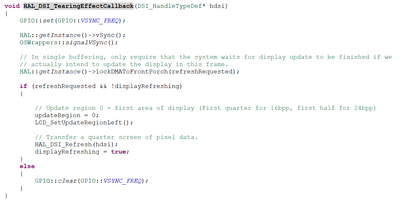

The touchgfx task starts and cycles as expected, with flushframebuffer being called. BUT, because there is no TE pin, the tearing effect callback never gets called and the below code never executes - I'm back at square 1! What should trigger this code instead of the Tearing Effect?
2024-11-14 8:10 AM
Sorted! I got it working with the example and then copied the TouchGFXHAL code to my custom project. The colours are wrong, but we're off to a good start!
