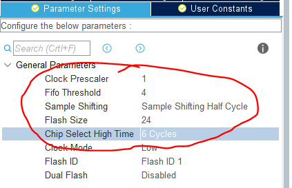

The only thing I would add is that a person might want to change the STM32CubeMX > Connectivity > QUADSPI settings to increase the size to what is available on the board. I ended up running out of space and needed to do that. And of course, as you stated, you only have one chance to generate the IOC file because it really messes things up if you do generate it again.
Here are the settings I used:0690X00000AQz1MQAT.png
 (From the link: https://touchgfx.zendesk.com/hc/en-us/articles/360019884752-Configuring-STM32F746G-DISCO)

I had the exact problem with the QSPI not working due to the fact that I didn't change the 'default settings'
In another thread (https://community.st.com/s/question/0D50X0000BI1CvjSQF/external-vs-internal-flash-memory-for-touchgfx-assets) I have found those exact settings - so instead of configuring the QSPI during the init of the project I will make another video detailing what to do to get the external flash to work.
I will mention:
  • Sdding an external loader as per Charles suggestions (yet another thread referred in the one above)
  • Setting the right QSPI details - the ones you show in your screenshot above
