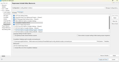

Hi everyone,
I’ve successfully created and imported a CMake-based project for the STM32F777NIH in STM32CubeIDE 2.0.0. The project builds and compiles without any issues.
However, the IDE cannot properly resolve headers, some macros, variables, and some struct definitions. To fix this, I enabled:
set(CMAKE_EXPORT_COMPILE_COMMANDS TRUE)
in my top-level CMakeLists.txt, which correctly generates a compile_commands.json.
In CubeIDE, I also enabled C/C++ General → Preprocessor Include Paths, Macros etc. → Providers → Compilation Database Parser, and pointed it to the generated compile_commands.json (AN5952).
But CubeIDE shows:
Invalid build parser
And the error log contains:
“Compilation database parser does not have a build command parser configured.”
So it seems CubeIDE refuses to use the compilation database to resolve include paths, even though the file exists and is valid.
Is there any known workaround to allow STM32CubeIDE to consume compile_commands.json for indexing?
Or any other reliable way to fix header/struct auto-completion and indexing issues when working with CMake-based STM32 projects?
Thanks in advance!

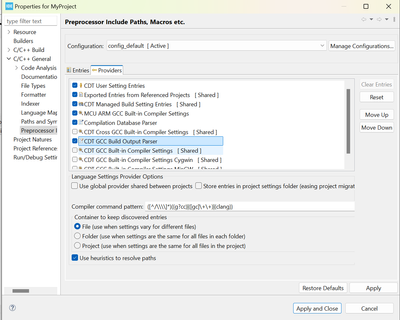

Hello @pmndt
First you need to tick the option " CDT GCC Build Output Parser " as shown in the following screenshot
Then go back to "Compilation Database Parser" and in Build Parser tab : select "CDT GCC Build Output Parser" as shown below
then apply and close.
THX
Ghofrane

Ghofrane GSOURI
Hello @pmndt
THX
Ghofrane
Thank you very much! This solved the indexing issue.

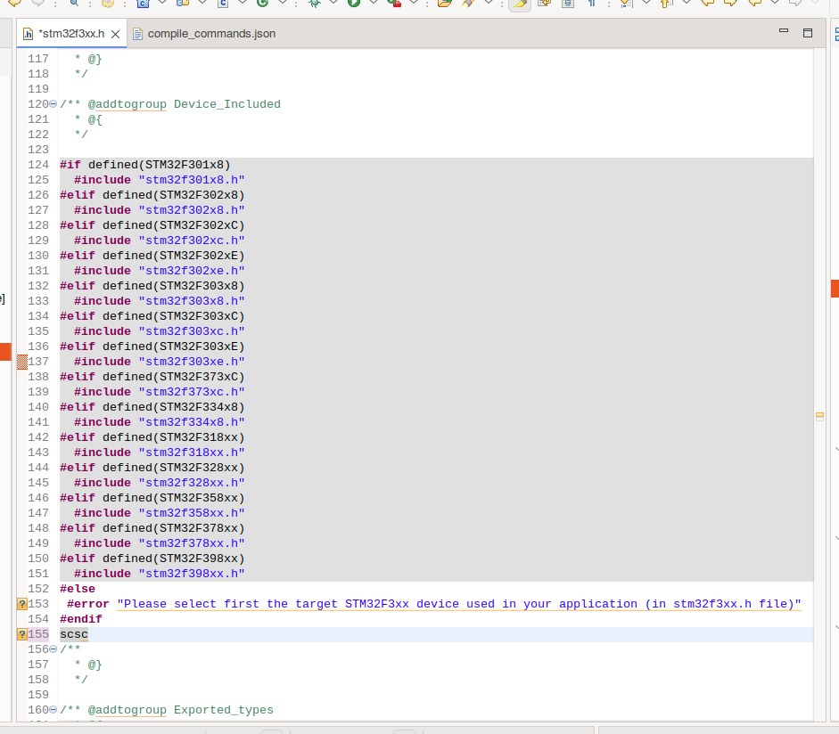

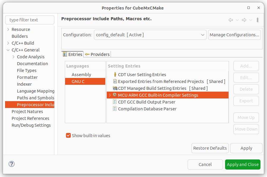

Fla
I followed your instructions, but the indexer is still not working.
Even after rebuilding the index I get no entries here:
And also syntax highlighting fails (macro STM32F303xE is set):
Any ideas?
Regards,
Norbert
