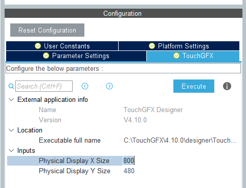

I was trying to follow the tutorial with the STM32F469 discovery kit. Everything worked fine until the point, where the display (without touch) should work after flashing the target. It deleted the touchGFX project that was on it before, the LEDs turned on, but the display went black.
I took a look at the default device configurations of the discovery kit (in STM32CubeIDE) and it looks like the display size does not match the actual display in the original kit. The size should be 800x480, but is configured as 480x272 and won't let me change it.
Build and debug is ok, it doesn't give me any errors. Do you know anything about this/what the problem might be? I somehow hope that it has something to do with the default device configurations, so the display is not activated correctly but then again I would not know what to do about that either.
Kind regards,
Gerda

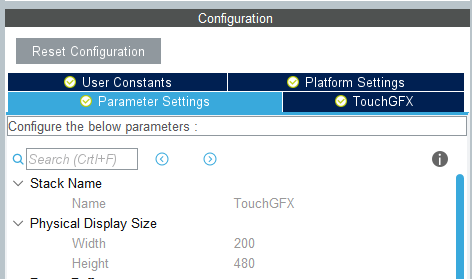

I recently went through the same process for the STM32F769-Discovery kit and had a similar result. No compile errors and when debugging to the kit, the screen was black. I have not been able to get it to work, but I was able to change the size. I could edit the X and Y sizes in CubeMX's Middleware > Graphics > Configuration TouchGFX section. Are you trying to edit the size in the TouchGFX section or the "Parameter Settings" section?
In my case I could edit the sizes in the TouchGFX section but not the "Parameter Settings" section which showed a size of 200x480:
But like I said, I still couldn't get anything on the Discovery kit's screen (it does work if I create a project in TouchGFX and use it's "Run Target" button).
Yes, I had tried this before, exactly the same here. I guess we're stuck at the same point.

You say it won't let you change the dimensions. Can you show me a screenshot?
Thanks.
/Martin
It actually is exactly the same that scottSD posted. I can change it in the TouchGFX section, but not in the Parameter Settings when configuring the graphics. But in the end it doesn't change anything when debugging - the display stays black.
The TouchGFX moduie inherits some settings from the LTDC, display size, for instance.
