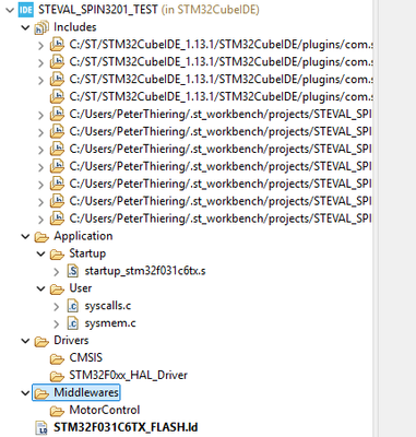

Project generated for STEVAL-SPIN3201 does not compile in STMCubeIDE
PThiering
Dear STM Community,
I'm familiar with the STM32CubeMX and the STM32CubeIDE, and I began discovering a motor control evaluation kit.
The default project generated with the motor control SDK does not compile with default settings (even without touching an option), even though Cube was able to generate a project, and switched miiediately to the IDE. Most of the files were missing, so I had to manually re-import the whole directory structure, and adding all folders with header files in. I never experienced such a problem with a project directly created with the CubeMX.
I've updated all STM tools to the latest version, tried to remove and re-download some STM firmware packages, I got further in the compile process, and stuck at a missing speed_duty_ctrl.h header, awhich I was not able to locate on my computer.
In the Motor Control Workbench, I selected STM32CubeIDE as target platform, with matching version numbers for the CubeMX.
STM32CubeIDE version: 2.0.0
STM32CubeMX version: 6.15.0
Motor Control Workbench version: 6.4.1
Latest compile error log:

PThiering
Dear Members,
I've finally got some time to reinstall the whole STM32Cube environment. After carefully making backups of the previous projects, then uninstalling, and wiping all files, workpspaces, and packages, then reinstalling the newest version of everything from scratch, the default project compiles as a charm for the first click.
I don't have an idea what was broken. I think, that after several version upgrades, and package installations, something went wrong in the Cube firmware package definitions.
Thanks for Your patience.

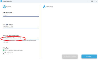

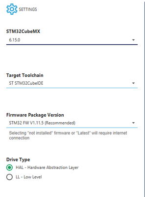

Once you have set all parameters in MC Workbench, and you proceed with Save & Generate, the tool will ask you to select a Firmware Package version.
You should normally choose the recommended version shown by the Workbench, because this is the version that has been tested and validated with your selected MCU, power board, and motor control features. Using the recommended package helps avoid compatibility or build issues.
If you are using an older project or want to test a newer firmware package, you can select a different version — but the safest option is always the recommended one.
PThiering

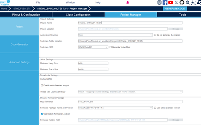

Hi, thanks for the tip. I always selected the "recommended" version, in my case, it was always matching the version installed in cubeMX.
See you later!

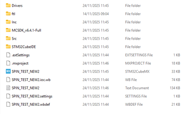

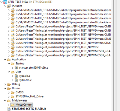

After making an empty project, with this settings, the same almost empty file system showed up in the IDE, without manually re-importing all subfolders. What is Your recommendation?
Esakkimuthu
Actually, you generated the project with the toolchain set to CubeIDE. My suggestion is:
  1. Generate the code normally.
  2. After the code generation finishes, open STM32CubeIDE.
  3. Go to File → Open Projects from File System…
  4. Select the STM32CubeIDE folder inside your project directory and import it.
  5. Build the project — it should compile properly.
Important: Before generating the code again, make sure to choose a different project name, not the same as the previous one. This should help solve the issue.
Did exactly the same. Result is not changed, only a few files are present in this folder. Imported from the "stm32cubeIDE" folder as filesystem. Important files are present, but outside of this folder... After copying everything inside from outside, the same issue begins, claiming some missing files in esc.c
Result on compile after Your instructions:

Result on compile after copying all outside files into the STM32CubeIDE folder:
../MCSDK_v6.4.1-Full/MotorControl/MCSDK/MCLib/Any/Src/esc.c:604:3: error: 'ESC_M1' undeclared (first use in this function); did you mean 'ESC_H'?
  604 |   ESC_M1.Ton_value = esc_capture_filter(&ESC_M1, LL_TIM_OC_GetCompareCH2(TIM2));
      |   ESC_H
../MCSDK_v6.4.1-Full/MotorControl/MCSDK/MCLib/Any/Src/esc.c:604:3: note: each undeclared identifier is reported only once for each function it appears in
arm-none-eabi-gcc "../MCSDK_v6.4.1-Full/MotorControl/MCSDK/MCLib/Any/Src/hall_speed_pos_fdbk_sixstep.c" -mcpu=cortex-m0 -std=gnu11 -g3 -DDEBUG -DARM_MATH_CM0 -DUSE_HAL_DRIVER -DSTM32F031x6 -c -I../../Inc -I../../Drivers/STM32F0xx_HAL_Driver/Inc -I../../Drivers/STM32F0xx_HAL_Driver/Inc/Legacy -I../../MCSDK_v6.4.1-Full/MotorControl/MCSDK/MCLib/Any/Inc -I../../MCSDK_v6.4.1-Full/MotorControl/MCSDK/MCLib/F0xx/Inc -I../../Drivers/CMSIS/Device/ST/STM32F0xx/Include -I../../Drivers/CMSIS/Include -I../../Drivers/CMSIS/DSP/Include -Ofast -ffunction-sections -fdata-sections -Wall -fstack-usage -fcyclomatic-complexity -MMD -MP -MF"MCSDK_v6.4.1-Full/MotorControl/MCSDK/MCLib/Any/Src/hall_speed_pos_fdbk_sixstep.d" -MT"MCSDK_v6.4.1-Full/MotorControl/MCSDK/MCLib/Any/Src/hall_speed_pos_fdbk_sixstep.o" --specs=nano.specs -mfloat-abi=soft -mthumb -o "MCSDK_v6.4.1-Full/MotorControl/MCSDK/MCLib/Any/Src/hall_speed_pos_fdbk_sixstep.o"
arm-none-eabi-gcc "../MCSDK_v6.4.1-Full/MotorControl/MCSDK/MCLib/Any/Src/inrush_current_limiter.c" -mcpu=cortex-m0 -std=gnu11 -g3 -DDEBUG -DARM_MATH_CM0 -DUSE_HAL_DRIVER -DSTM32F031x6 -c -I../../Inc -I../../Drivers/STM32F0xx_HAL_Driver/Inc -I../../Drivers/STM32F0xx_HAL_Driver/Inc/Legacy -I../../MCSDK_v6.4.1-Full/MotorControl/MCSDK/MCLib/Any/Inc -I../../MCSDK_v6.4.1-Full/MotorControl/MCSDK/MCLib/F0xx/Inc -I../../Drivers/CMSIS/Device/ST/STM32F0xx/Include -I../../Drivers/CMSIS/Include -I../../Drivers/CMSIS/DSP/Include -Ofast -ffunction-sections -fdata-sections -Wall -fstack-usage -fcyclomatic-complexity -MMD -MP -MF"MCSDK_v6.4.1-Full/MotorControl/MCSDK/MCLib/Any/Src/inrush_current_limiter.d" -MT"MCSDK_v6.4.1-Full/MotorControl/MCSDK/MCLib/Any/Src/inrush_current_limiter.o" --specs=nano.specs -mfloat-abi=soft -mthumb -o "MCSDK_v6.4.1-Full/MotorControl/MCSDK/MCLib/Any/Src/inrush_current_limiter.o"
make: *** [MCSDK_v6.4.1-Full/MotorControl/MCSDK/MCLib/Any/Src/subdir.mk:154: MCSDK_v6.4.1-Full/MotorControl/MCSDK/MCLib/Any/Src/esc.o] Error 1​

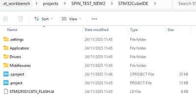

Esakkimuthu

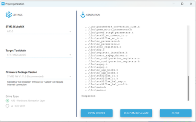

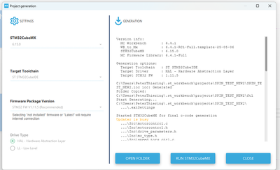

Please generate the code in MC Workbench, and once it is completed, take a screenshot and share it with me. Also, ensure that you are logged in to your STM account so that all required firmware packages and updates are properly installed. After you send the screenshot, I will review it. I suspect the code may not be generating properly, possibly due to missing or incomplete firmware packages.
Thanks, it seems to be the issue, but I don't know which packages are missing. Generation completes without any errors. I had to strip the log to fit into the 30k characters limit.
In the generated folder, STM32CubeIDE/Middlewares/MotorControl is empty. These files may be in the folder MCSDK_v6.4.1-Full/Motorcontrol. That's what I copied in the previous attempt into the Middlewares, but I still encountered missing linked files. If You cannot figure it out what is missing, I think I will uninstall and wipe the whole STM32CubeMX/IDE/Programmer toolchain, and I will try to reinstall everything from scratch.
