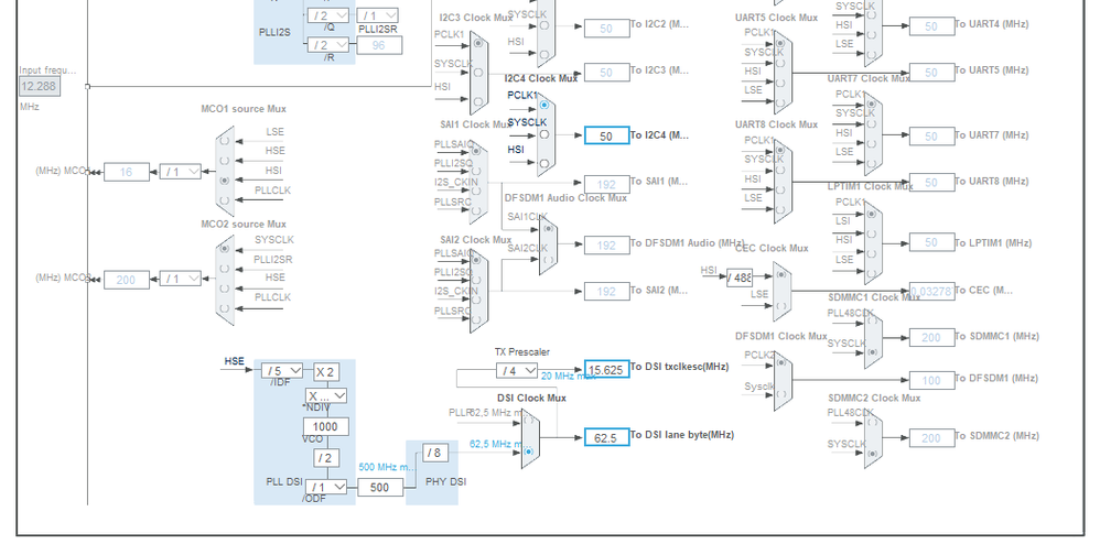

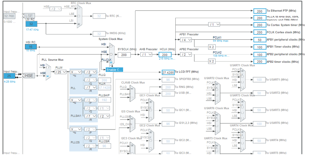

  • Could you show me your clock config ?

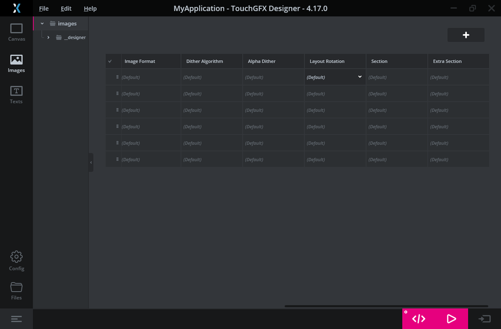

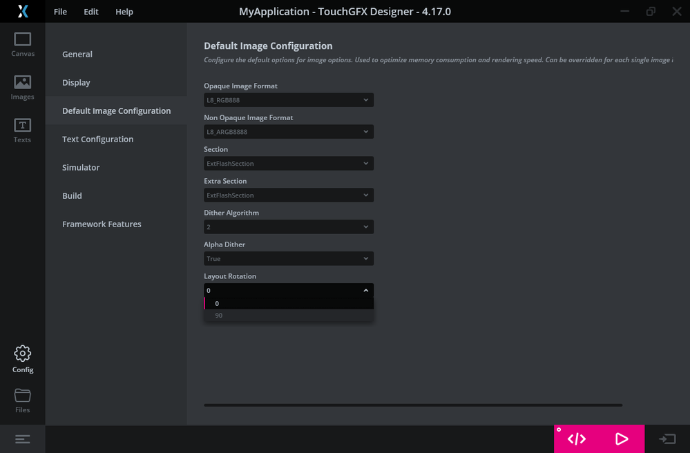

Basic user mistake. Set default image angle to 90 / 0 based to your hw lcd orientation.
@MM..1​ Already I checked with both the orientations, same results.
Realy you regenerate code after change
0693W00000NpceNQAR.pngand on all images have default ?

Sorry I now check your image more and you need check and correct LCD setup plus if using DSI use calculated values not real...
For example if LCD datasheet say horizontal sync 7 pixels you need in LTDC 7 corrected in code to 7-1 and in DSI
7 x DSICLK/DOTCLK rounded up.
