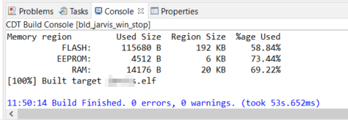

Dear Members,
I have question related with BMP reading from SDcard then display to LCD ?
It stopped in one file,
Is it related with internal SRAM of my STM32F103, and I'm running out of internal SRAM memory,
I read some bmp files, and freeze.
Regards,

"It stopped in one file"
What, exactly, does that mean? What debugging have you done to find out what's going on?
"Is it related with internal SRAM of my STM32F103, and I'm running out of internal SRAM memory,"
Doesn't your IDE give you information on that?
eg, STM32CubeIDE:
"I read some bmp files"
So how big are those files? How does that compare to the amount of available RAM?

Hi Andrew,
Thanks for the reply,
The bmp file size is 320x240x16K colors,
Compiling result :
0693W00000NphKrQAJ.pngany clues ?
Regards,
Rixtronix
Again, what debugging have you done to find out what's going on?
"The bmp file size is 320x240x16K colors"
So have you done the basic maths?
320x240 = 76800 pixels.
For 16K colours, that must be at least 14 bits per pixel; presumably, you use 2 bytes?
So that's a total of 76800 x 2 = 153600 bytes = 150 K bytes for each file.
Are you trying to store all the files in memory at the same time?
