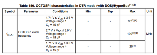

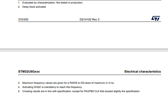

Could you please try to decrease the OCTOSPI clock frequency.
The max OCTOSPI clock frequency for STM32U5G is 100 MHz
I hope this help you.

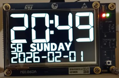

wegi01
Just by the way I'm using opensource library stb_truetype.
I understand it's maybe a palliative solution but it work. Library exists in only one file: "stb_truetype.h" is downloaded from here:
 https://github.com/nothings/stb
And example how I used this is here:
https://github.com/wegi1/STM32U5G9J-DK2-RTC
