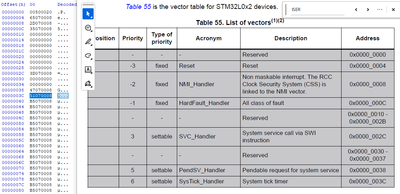

Hello, I have a problem with SysTick interrupt on STM32L072KZUX.
I am using the latest version of STM32CubeIDE + the latest package for my MCU - FW_L0 1.12.3. An absolutely clean project, which was created in IDE and flashed into the device using ST-Link, starts up fine after flashing, but when the SysTick count reaches overflow and an interrupt should be called, for some reason the program goes to the wrong address (PC = 0x1ff00dd0), of course the interrupt handler itself is declared and there is a pointer to the function in the assembler file. Moreover, it does not matter which framework to use: LL or HAL. I checked the vector table both in the firmware image and in the microcontroller memory, all addresses are correct. Moreover, it does not matter how to use it. We checked it on 2 chips from the same batch, a similar program flashed into NUCLEO-L073RZ works correctly.

// Map listening file is
                0x20005000                        _estack = (ORIGIN (RAM) + LENGTH (RAM))
                0x00000200                        _Min_Heap_Size = 0x200
                0x00000400                        _Min_Stack_Size = 0x400
.isr_vector     0x08000000       0xc0
                0x08000000                        . = ALIGN (0x4)
 *(.isr_vector)
 .isr_vector    0x08000000       0xc0 ./Core/Startup/startup_stm32l072kzux.o
                0x08000000                g_pfnVectors
                0x080000c0                        . = ALIGN (0x4)
.text           0x080000c0      0x9b0
 .text.SysTick_Handler
                0x08000750        0xa ./Core/Src/stm32l0xx_it.o
                0x08000750                SysTick_Handler
kuzdmin
The problem was in the connected BOOT0 pin, which caused interrupts to call the handler from system memory.
