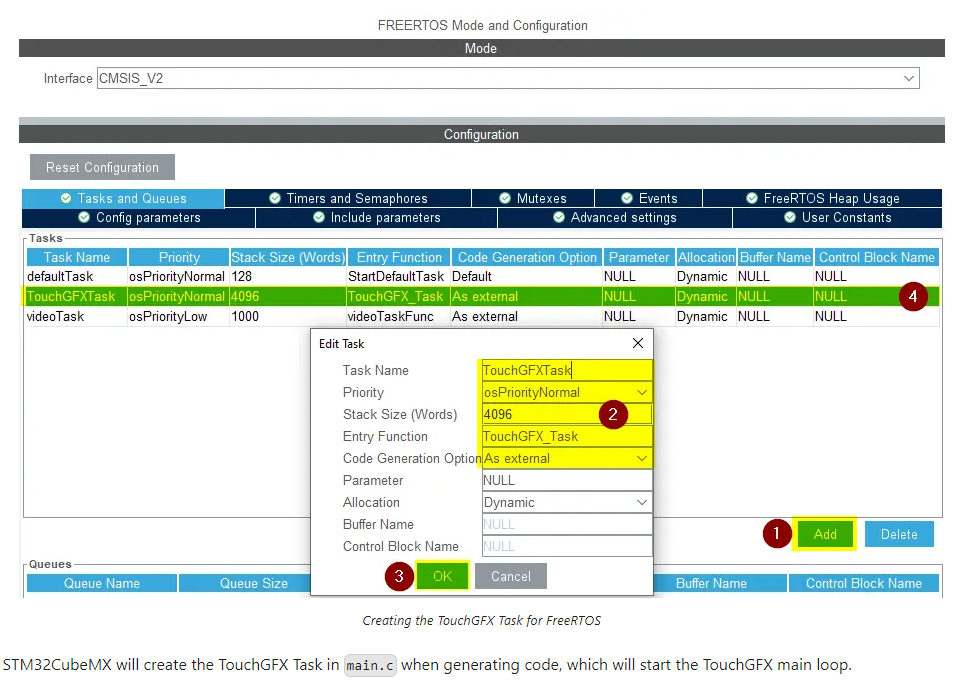

I've enabled FreeRTOS and have two tasks enabled, one blinking an LED that is working. The other set up for TouchGFXTask like the instructions.

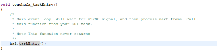

0693W00000Y9ypSQAR.png Which creates the task, I can follow it into app_touchgfx.c, and on to TouchGFXConfiguration.cpp

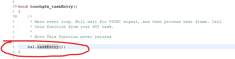

0693W00000Y9yqGQAR.pngThe hal.taskEntry() takes me to HAL.hpp. No where else.

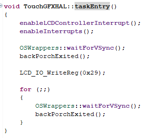

Looking at another example the hal.TaskEntry() goes to TouchGFXHAL.cpp and has code:0693W00000Y9yquQAB.pngWhat should be at hal.taskEntry()?

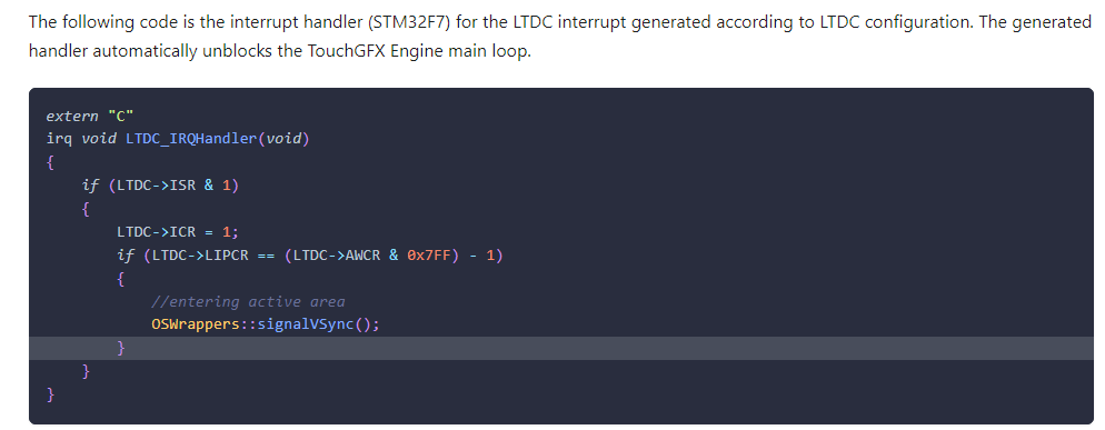

The instructions also reference the LTDC_IRQHandler again. I don't find this section of code below anywhere. Should I add it and if so where? Now that I have enabled FREERTOS, the LTDC_IRQHandler in stm32l4xx_it.c doesn't get raised.
0693W00000Y9yrdQAB.pnghere:
https://support.touchgfx.com/4.21/docs/development/touchgfx-hal-development/scenarios/scenarios-ltdc-parallel-rgb

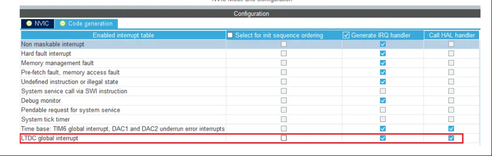

NVIC is enabled like the screen shot below. The interupt was getting called before I enabled FreeRTOS.
0693W00000YA4wQQAT.pngI checked vsync and hsync with scope the signals look good.

After I setup FreeRTOS like this:
0693W00000YA53vQAD.pngI can drill into the task it created,
0693W00000YA5MwQAL.pngto hal.taskEntry(), there is no code / function for hal.taskEntry(). Shouldn't TouchGFX have generated the code?

With much help from "MM..1" he figured out that touch GFX version 4.21.1 generated bad code for the the STM32L49. When we used version 4.17 the display worked. I also tested on version 4.20 and the code generated works. I also had " HAL_LTDC_SetAddress(&hltdc, framebuffer, LTDC_LAYER_1);" still in my code from earlier testing, this wasn't needed after it was verified that the display color would change and I was enabling touchGFX.

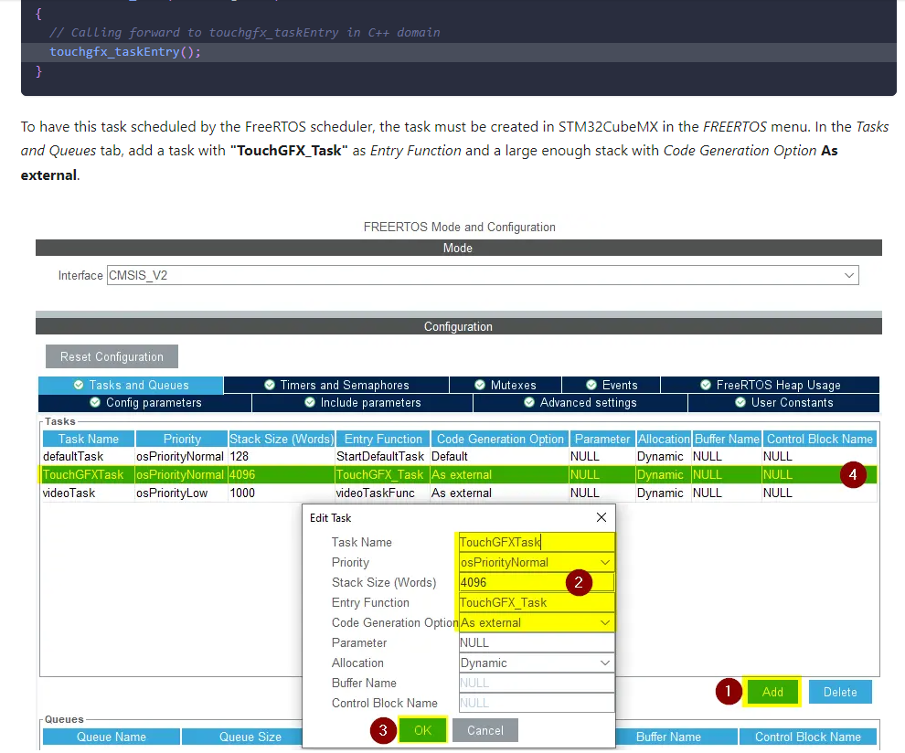

Follow up on the 4.21.1 version: I increased the RTOS Heap to 40k and the task stack size to 5000, then the display worked. I tried to figure which change made the display work, and set the heap back to 30k and task stack size to 4096 and the display still worked. This is the same project and version that didn't work a couple of days ago. The only other significant change I made between then and now is I installed 4.21.0 to see if the display would work with 4.21.0. After I verified 4.21.0 worked I made the heap and stack changes to 4.21.1. I don't remember making any other changes to that project. I was hoping to narrow down the change that fixed it, I'm not sure if 4.21.1 needed something that was installed/updated by 4.21.0, or something else changed that made it work?
