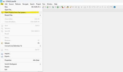

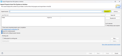

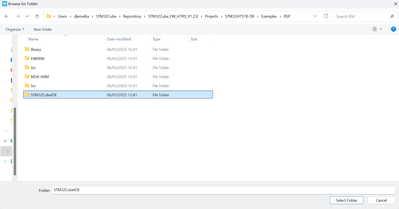

To open BSP example, could you please use the latest STM32CubeIDE toolchain and follow these steps:
1- Click on File>open projects from File System
2- Click on Directory
3. Choose the path of BSP example then click on Select Folder

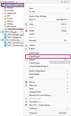

Hello @Jorge Alves ;
I can reproduce the issue on my side and I reported internally for checking.
But, after click on "Clean Project" the issue is solved.
Could you please try to clean the project and let me know if the issue is solved or not?
