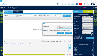

STM32CubeProgrammer GUI incorrect display of english characters
PythonMan
Maybe I need to install the appropriate font? (Version 2.19-2.20)
2 REPLIES 2
Did you restart STM32CubeProgrammer as it states? Were fonts still incorrect after restart?
PythonMan
I tried restarting the program, also tried reinstalling, changed the Windows language to English.
Some text is displayed normally, so I assumed that the font used by the program is simply missing from the recovery, but I don't know which one. The program CubeMX works correctly.
