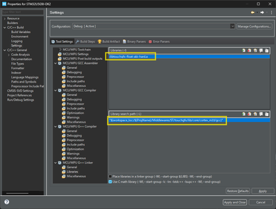

Error message:
c:\st\stm32cubeide_1.8.0\stm32cubeide\plugins\com.st.stm32cube.ide.mcu.externaltools.gnu-tools-for-stm32.9-2020-q2-update.win32_2.0.0.202105311346\tools\arm-none-eabi\bin\ld.exe: ./TouchGFX/generated/fonts/src/CachedFont.o: in function `touchgfx::ConstFont::~ConstFont()':
C:/Users/mande/Documents/STM32/STM2New2/STMF207New2/Debug/../Middlewares/ST/touchgfx/framework/include/touchgfx/ConstFont.hpp:35: undefined reference to `vtable for touchgfx::ConstFont'

‎2023-11-20 7:40 AM
I am seeing the same error in ConstFont, was this solved? If so how?
thanks.

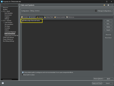

‎2024-07-22 8:53 PM
You must link with the TouchGFX core library. Depending on your MCU, this would be either
‎2024-07-26 7:48 AM
Thank you! This solved a similar problem that I was having.
