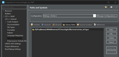

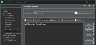

I also tried generating a TouchGFX GUI code, and now I'm getting this error.
I tried solving it as described here: https://community.st.com/t5/stm32-mcus-touchgfx-and-gui/cannot-build-project-with-cubeide-undefined-reference-to/td-p/699214
The project has already been converted to C++.

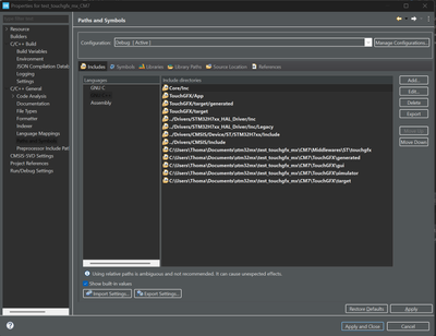

I have also added all the Folder
I keep getting the same errors. I would really appreciate any help. Thank you very much.

Hello @ThomasBader ,
You have to first generate code throught STM32CubeMX, then generate code through TouchGFX and then you can build in STM32CubeIDE.
When you generate code in STM32CubeMX, mak esure to UNcheck the "generated under root" checkmark :
Also, your fodler structure is not really identical to the dual cortex TBS available in TouchGFX Designer.
You can start a project with a dual core such as the STM32H745-dk to see how we implemented TouchGFX on this kind of device.
