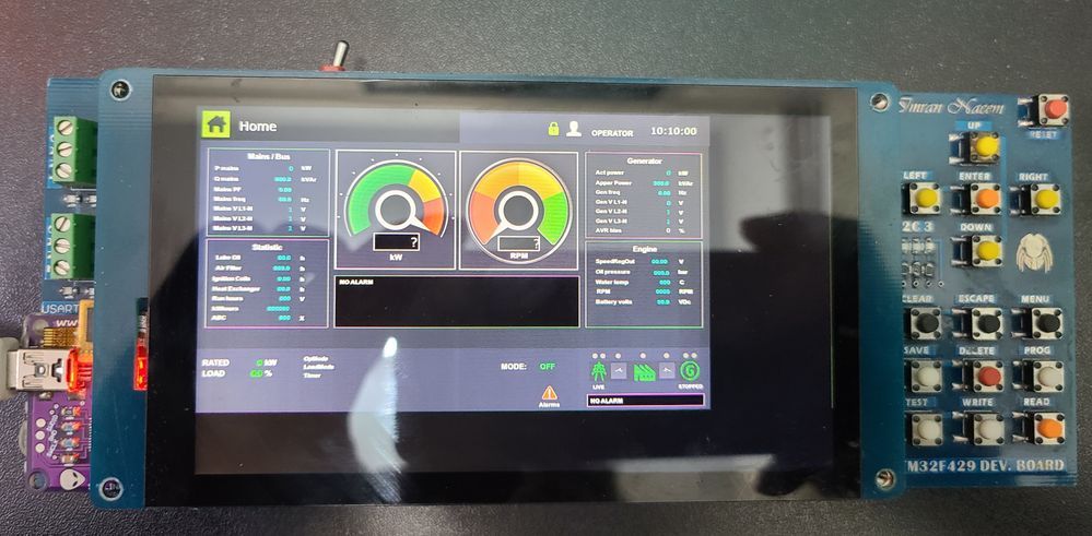

I have good experience interfacing non-standard boards with touchgfx.
I will recommend you , first implement LTDC and play with colors . then implement TouchGFX.
Following is one of my old experiment with STM32F429 discovery (on the back) and 720x1280 RGB TFT.
regards
