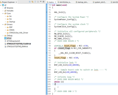

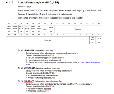

On nucleo_u575zi_q below observations has been captured.
Issue: - when IWDGRSTF flag is cleared by writing to the RMVF bit still watchdog reset occurred.
Expected Behavior: - When the IWDGRSTF flag is cleared by writing to the RMVF bit, the watchdog reset should not occur.
Please find the below snippet of sample code of STM32cubeIDE.
Also find the reference of user Manul and data sheet of nucleo_u575zi_q board.
Please provide appropriate solution for the above issue.

Ozone
Principal III
Why do you expect such a behavior ?
Nowhere is stated that any access to said flag will stop the IWDG.

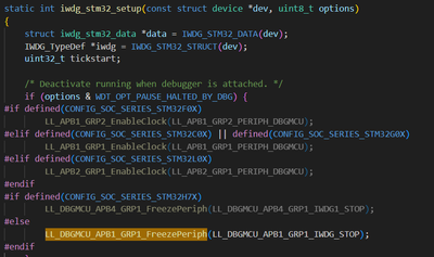

RahulPatil_123
LL_DBGMCU_APB1_GRP1_FreezePeriph(LL_DBGMCU_APB1_GRP1_IWDG_STOP);
what is meaning of above snippet code and above function can you please explain?
what does the below micro
 DBGMCU_CR_DBG_STOP_Msk              (0x1UL << DBGMCU_CR_DBG_STOP_Pos
To halt IWDG during debug, set DBG_IWDG_STOP in DBGMCU_APB1LFZR.
