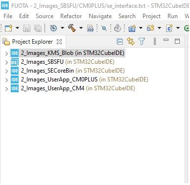

I am trying to compile the SBSFU_2_Images_DualCore project.
Although I did it in the correct order according to the document "Getting started with the SBSFU of STM32CubeWL (UM2767)". I am getting a compiler error.
I'm sure that, compiling the correct order according to Getting started with the SBSFU of STM32CubeWL (UM2767)
Compile order is;
- 2_Images_SECoreBin - compile success
- 2_Images_KMS_Blob - compile success
- 2_Images_SBSFU
- 2_Images_SBSFU_CM0PLUS - compile success
- 2_Images_SBSFU_CM4) - compile success
- 2_Images_UserApp_CM4 - compile success
- 2_Images_UserApp_CM0PLUS - compiler error
The error is multiple definition error .
