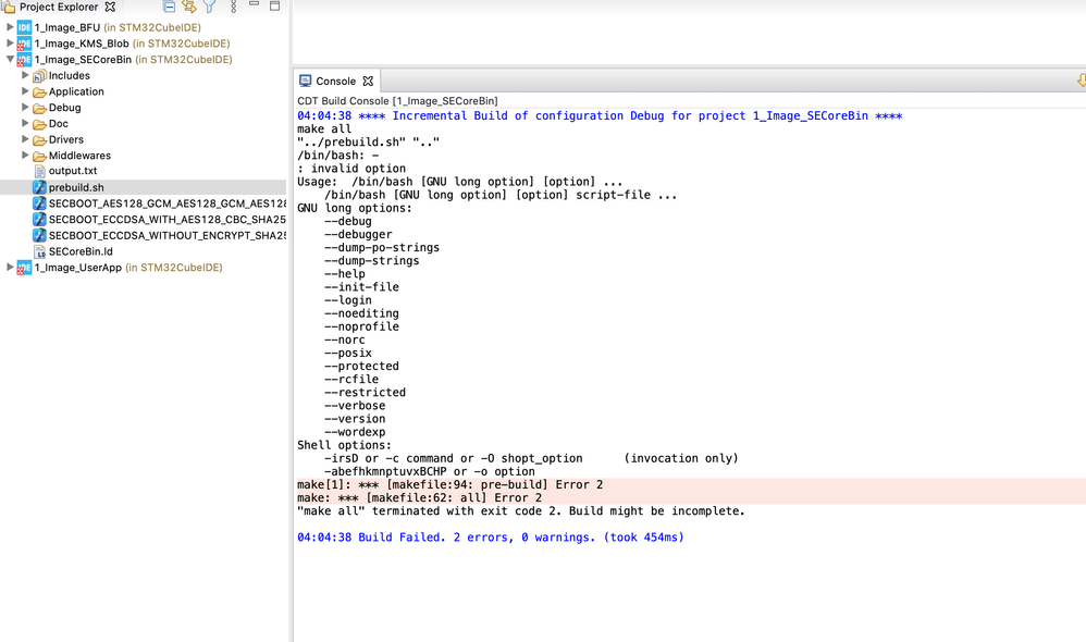

I am working on a project using STM32Cube_FW_WL_V1.0.0.
I cannot compile the 1_Image_SECoreBin project included in the BFU_1_Image sample project.
I am using STM32CubeIde on macOS Catalina.
I have also read these manuals.
"Getting started with the SBSFU of STM32CubeWL"
"Integration guide of SBSFU on STM32CubeWL (including KMS)"
Can you guys guide me?

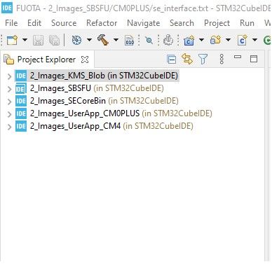

FYASA.1
Hi there,
I also tried on Windows 10.
I installed necessary tool chain for STM32CubeMXIde.
Then I prepared SBSFU_2_Images_DualCore sample project
I'm sure that, compiling the correct order according to Getting started with the SBSFU of STM32CubeWL (UM2767)
Compile order is;
  • 2_Images_SECoreBin - compile success
  • 2_Images_KMS_Blob - compile success
  • 2_Images_SBSFU
    • 2_Images_SBSFU_CM0PLUS - compile success
    • 2_Images_SBSFU_CM4) - compile success
  • 2_Images_UserApp_CM4 - compile success
  • 2_Images_UserApp_CM0PLUS - compiler error
The error is multiple definition error .

I didn't do any code change, I just downloaded and opened in STM32CubeIde.
Is this related with STM32Cube_FW_WL_V1.0.0 ?
What's wrong ?
Thank you

Thank you Jocelyn,
The problem was caused by the macos. Catalina version uses default zsh instead of bash.
As a solution for those who encounter a similar problem: https://www.howtogeek.com/444596/how-to-change-the-default-shell-to-bash-in-macos-catalina/
