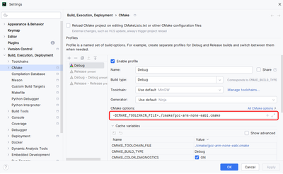

Best answer by Ghofrane GSOURI
Hello @Mocozzz
The root cause of the issue is related to how the toolchain file was specified in previous MX versions. Previously, the toolchain file was defined in two locations: CMakePresets.cmake and CMakeLists.txt.
Starting with version 6.15, the specification in CMakeLists.txt has been removed, and it is now retained only in CMakePresets.cmake. This change was made to eliminate redundancy and to simplify switching between GCC and starm-clang .
To be able to build the 6.15 projects with Clion we need to specify the toolchain file in the Clion project:
- Go to menu File -> Settings -> Build, Execution, Deployment -> CMake
- In “CMake options” field , we need to add the toolchain file variable for GCC :
     -DCMAKE_TOOLCHAIN_FILE=./cmake/gcc-arm-none-eabi.cmake
Note: To use starm-clng instead of gcc, we need to add : -DCMAKE_TOOLCHAIN_FILE=./cmake/starm-clang.cmake
THX
