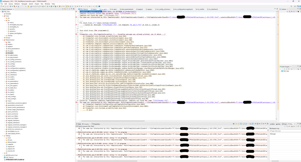

I got several FreeMarker template errors when I tried to compile the code to test out EVLSPIN32G0A1. It looks like all the files under MotorControl folder were affected by what I assume is the same error type (see attached picture).
FreeMarker template errorFreeMarker template error. The steps to reproduce this error are as shown below.

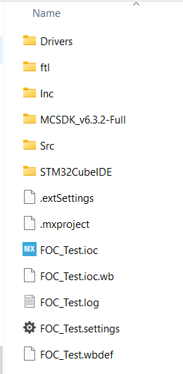

Have you generated your project from Motor Control Workbench or from CubeMx tool? It is mentioned in the log that one file is missing (header.ftl). Could you check that "ftl" directory is present on your project directory (at same level as "Src" and "Inc").
If project has been generated by Motor Control Workbench tool, could you share your stwb6 file?
If you agree with the answer, please accept it by clicking on 'Best answer'.Best regards.GMA
BamAuthor
May 16, 2025
The ftl folder is present in the project directory.
Attached is the stwb6 file (remove .txt extension). I have also included the ioc file in case you need it.

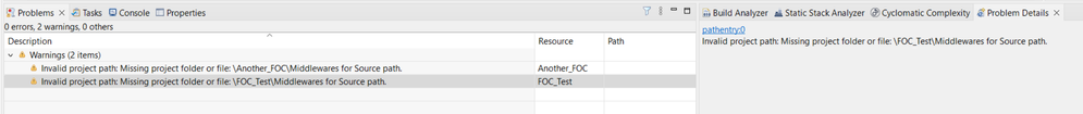

I saw this warning in the previous project. I'm not sure if it is part of the issue.
BamAuthor
May 16, 2025
The new project gave the same warning.

Finally figured out the issue. I was trying to use the ioc file to create the project directly from STM32CubeIDE. The correct way of doing this is to use the project file located in workbench folder:
..\.st_workbench\projects\Another_FOC\Another_FOC\STM32CubeIDE\.project
Hopefully this helps someone else in the similar situation.
