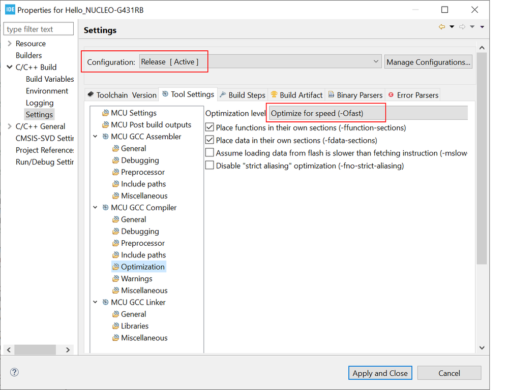

in STM32CubeIDE menu: Project > Properties > C/C++ Build > Settings
Also be sure that you have a separate Debug+Run configuration loading the release code (.elf) to the board.
