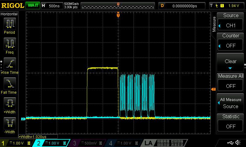

First, I would like to know if this code is correct to setup SPI to re-transmit by DMA again.
GPIOA->BSRR = (1<<5); // start
  DMA1->IFCR = 0x0FFFFFFF; // reset status
  DMA1_Channel3->CCR &= ~( DMA_CCR_EN );
  LL_DMA_SetDataLength(DMA1, LL_DMA_CHANNEL_3, ubNbDataToTransmit);
  DMA1_Channel3->CCR |= ( DMA_CCR_EN );
  GPIOA->BSRR = (1<<21); // reset/end +16
when taking the duration of the whole code, it is taking around 1uS as shown below.
CH1 (yellow) = GPIOA5
CH2 (blue) = SPI clk
Why is it taking around 1uS to execute these codes?

Whats your MCU clock? Compiler settings?
You could use your GPIOA5 instrumentation for a code bisection.

Okay, I dug out my Nucleo STM32G431RB and made some tests with gcc and 170 MHz core clock. In Debug mode, 194 clock cycles, in release with -Ofast and minimum debug info (-g1) 47 clock cycles. The first figure matches about your observed 1µs.
Used the cycle counter for measurement:
ITM->LAR = 0xC5ACCE55;
CoreDebug->DEMCR |= CoreDebug_DEMCR_TRCENA_Msk;
DWT->CTRL |= DWT_CTRL_CYCCNTENA_Msk;
LD2_GPIO_Port->BSRR = LD2_Pin;
uint32_t tick = DWT->CYCCNT;
LL_DMA_SetDataLength(DMA1, LL_DMA_CHANNEL_3, 64 );
uint32_t tock = DWT->CYCCNT;
LD2_GPIO_Port->BSRR = LD2_Pin<<16;
In debug mode, the call to LL_DMA_SetDataLength is a function call, in release mode it is inlined.

Yes, these codes where in GPIO interrupt.
When I checked the codes again, I forgot to remove the "first" GPIO set high so it measured also the GPIO interrupt flags.
void EXTI15_10_IRQHandler(void)
  /* USER CODE BEGIN EXTI15_10_IRQn 0 */
  /* USER CODE END EXTI15_10_IRQn 0 */
  if (LL_EXTI_IsActiveFlag_0_31(LL_EXTI_LINE_13) != RESET)
    LL_EXTI_ClearFlag_0_31(LL_EXTI_LINE_13);
    /* USER CODE BEGIN LL_EXTI_LINE_13 */
    /* USER CODE END LL_EXTI_LINE_13 */
  /* USER CODE BEGIN EXTI15_10_IRQn 1 */
  /* USER CODE END EXTI15_10_IRQn 1 */
 After removing it, it went down to 600nS, which I think is still quite long.
Hi I am using NUCLEO-G474RE @ 170Mhz and found some error in the code which made the measurement include the the clearing of flags in the GPIO interrupt (shown above).
After modifying it, it went down from 1uS, it went down to 600nS which I think still quite long.
I did also Release compile (select Release under the Hammer button), but still get 600nS. Not much difference bet ween Release and Debug compile.
