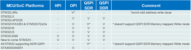

As a more general comment, there are a couple of different cases
- STM32 which have only QSPI NOR memory controller. Memory Mapped Write function is not implemented. It can support QSPI SDR RAM (all APS1604M-3SQR, APS1604M-SQR APS6404L-3SQR, APS6404L-SQR, APS12804O-SQRH)
-   STM32 which have Octal/QSPI memory controller, supporting Octal and QSPI DDR full spec, but still have a limitation for QSPI SDR. This applies to STM32H7Ax/Bx and STM32H72x/3x. Recommendation to use OPI RAM such as APS6408L-OBM, APS6408L-3OBM, APS12808L-3OBM, APS12808L-OBM, APS12808O-OBR, APS256XX-OB9, APS512XX-OB9.
- STM32 which have Hexa/Octal/QSPI memory controller which support all device full spec. This applies to all new MCU coming, including  STM32L4P, STM32L5, STM32H5, STM32U5, ....Any IOT RAM can be used from 16Mb up to 512Mb, 6pins QSPI SDR, 7 pins QSPI DDR, 11pins OPI, 20 pins HPI, supporting up to 1GB/s in wide range of package such as SOP8/USON8, BGA24 and WLCSP.  IoT RAM is the most effective memory solution, key attributes such as pin count, power, space saving, simplicity of design and competitiveness  (https://eu.mouser.com/c/?tradename=APMemory)
- Overview in below table:
https://www.st.com/en/partner-products-and-services/iot-ram-opi-psram.html
https://www.st.com/en/partner-products-and-services/iot-ram-hpi-opi-psram.html
https://www.st.com/en/partner-products-and-services/iot-ram-spi-qspi-psram.html
