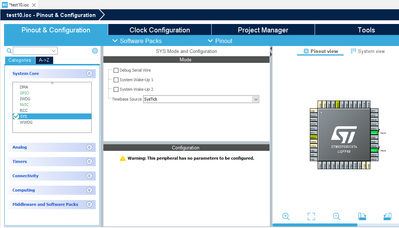

‎2024-11-18 10:11 PM
I am reading what you say by translating. I do not understand some of the statements. Is TimeBase Source: SysTick selected?
‎2024-11-18 10:32 PM
‎2024-11-18 11:30 PM
TIM16 and debug serial wire .

‎2024-11-19 1:59 AM
timer16 and SerialWire what do you want me to do
