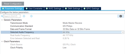

According to this, I have set the I2S pins as Half Duplex Master, with following settings -

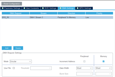

The DMA settings is given below -
Here as the frame size is 32-bits, I have set data width as 'word'.

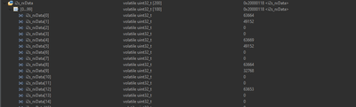

Now, my expectation was that each entry on data buffer would be a 32-bit number, but it seems I get 16-bit each entry. In debug mode, this is how the DMA buffer looks like.
The pattern is, 2 numbers 16-bit numbers, ending with two zeros. I dont know exactly why it behaves like this.
So, I considered each 4 buffer entry as 1 audio data and did the needed bit shifting -

I have tried changing *Data and Data Frame format* on I2S settings and also Data Width from DMA request settings, but I am no sure where it's not going perfect.
