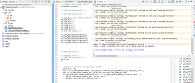

Wait but MCU is unblocked
‎2024-11-17 6:02 AM - edited ‎2024-11-19 2:37 AM
I haven't been able to wait 500ms without affecting the timers for 7 days.
In this block, doesn't PB14 become "0" after 500ms?
Even if I use comment lines, it doesn't work.
Note: volatile uint32_t Counter = 0;
The "Counter" variable is incremented every 1ms with Timer16.
** STM32F030C6T6 I'm using.
** Own PCB board..
*** Note: Card of a working system.. There is no card design error.
if(htim->Instance==TIM16)
Counter++;

‎2024-11-18 3:10 AM
I will try but the problem must be somewhere else.
because
even the code above does not work. b14 is not active or passive.

‎2024-11-18 4:53 AM
if (HAL_GetTick() - tick_start >= 500) {
HAL_GPIO_TogglePin(GPIOB, GPIO_PIN_12); //
HAL_GPIO_TogglePin(GPIOB, GPIO_PIN_13);
HAL_GPIO_TogglePin(GPIOB, GPIO_PIN_14);
tick_start = HAL_GetTick(); //
even this code is not working.
I think there is a problem with HAL_GetTick();..
HAL_GetTick(); may not be working.
‎2024-11-18 6:54 AM - edited ‎2024-11-18 7:06 AM
Seems you project isnt configured... HAL_IncTick is in Systick IT handler , but systick isnt configured...
How you manage project ? CubeMX ?
Or timers is misconfigured and ISR took long, then main code never run. Know you how debug code?
Try comment all timers out.

I am using stm32cubeide. If I send you my project file, can you review it? Just find my mistake about the hal_gettick(); function. I control my project with timers. I don't understand which one is longer.
‎2024-11-18 8:04 AM
I use test5.rar and main.c , and try send you back working code.
‎2024-11-18 8:43 AM
I don't know which file is in test 5, but the solution you make there will still be useful to me.
‎2024-11-18 9:05 AM
Try this main file
