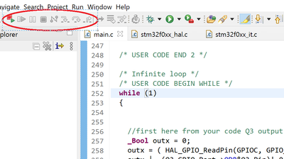

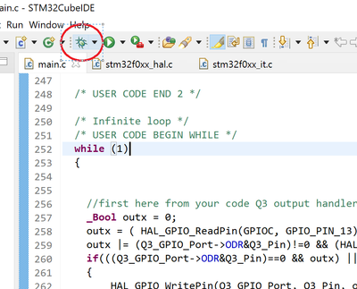

‎2024-11-18 10:37 AM
Know you how debug code ?
‎2024-11-18 10:48 AM
I don't know
‎2024-11-18 10:59 AM

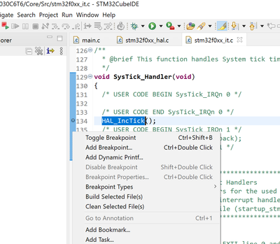

then switch to it.c and click on line set break point , on left click play button learn use debuger ...

‎2024-11-18 12:47 PM
Make sure that SysTick is causing HAL_GetTick() to advance.
If it is not, then HAL_Delay() will not work.
Make sure all the input and output lines are functional.
Need to start from first principles, and confirm what is and what isn't working.

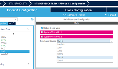

Seems you choice ST versions with some bugy frameworks. I understand your frustration , but try remove systick and use other timebase. Start with open ioc and free TIM16 disable it.
Then choice here
and test your HAL_Delay 500 toggle or my code.
