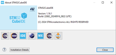

If you tell me your board, MCU and STM32CubeMX version I can check. Hal_delay works perfectly fine in my projects. I cannot replicate your situation if I don't know the details.

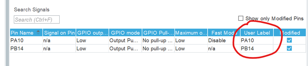

Does your board contain an LED?
Have you tried to make a blinky?
Can you send your ioc file?

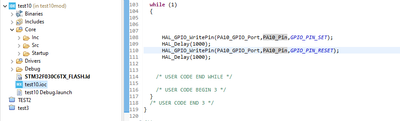

2024-11-19 3:28 AM - edited 2024-11-19 3:28 AM
PA10 is SET but not RESET. It remains stuck in the SET position.

Please give pins functional names. It makes it easier to use it in code using the generated defines in main.h:
#define YOURPINNAME_Pin GPIO_PIN_14
#define YOURPINNAME_GPIO_Port GPIOB
I noticed pin PINB12 and PINC13 referenced in your start post are missing in the configuration. Please configure all iopins

I'll take care of them, so why isn't Hal_delay working?
My problem is exactly that the hal_delay function isn't working.
I didn't care about the names because I was writing a test program.
