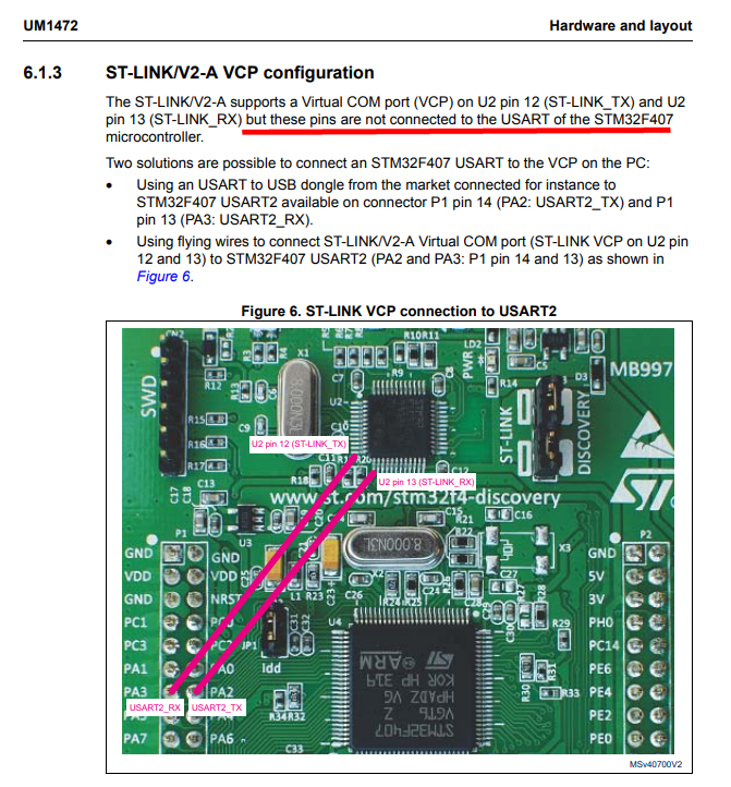

‎2024-09-16 8:06 AM - edited ‎2024-09-16 8:07 AM
@AHayee wrote:I am using STM32F407DISCO board
How are you connecting to the UART?
This board requires you to make the connection manually from the UART to the ST-Link's VCP:
Are you sure that your connections are secure & reliable?
