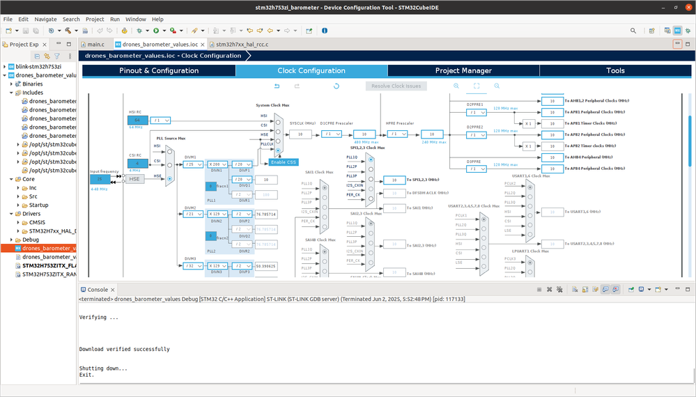

I have been using the STM32H753ZI100_24  for getting pressure data from the MS5611-01BA03 mems sensor. The debugger stops at SystemClock_Config() function in the code of reading prom registers from the MS5611-01BA03  sensor as per the datasheet Barometre datasheet

I will also attach the SystemClock_Config function.

In this function since i have only enable HSE clock but our custom board have both HSE and LSE in it.
Coming back to code in this HAL_RCC_OscConfig() function the debugger stops at the below while loop
while (__HAL_RCC_GET_FLAG(RCC_FLAG_HSERDY) == 0U)
          if ((uint32_t)(HAL_GetTick() - tickstart) > HSE_TIMEOUT_VALUE)
            return HAL_TIMEOUT;
it toggles between while() statement and if() statement. is it normal for the oscillator to start after toggling it so many times or is the there any problem in enabling clock from my side
the clock for spi is connected to APB2 which is 25 MHz. I have attach the photo of the clock configuration of the above project.
and the stm32 datasheet stm32 datasheet which we are using.
If HSERDY fails to get set, there is probably an issue with the HSE oscillator circuit. Can you show your schematic? Ensure the oscillator and load caps are appropriate.

This doesn't seem to have anything at all to do with the MS5611-01BA03 mems sensor - SystemClock_Config() is called long before anything happens related to the sensor!
So it's purely an STM32 thing?
yes i checked with the team. its due to the problem with the oscillator
mƎALLEm

The system clock is a first stage clock initialization of the MCU. The sensor config (I think SPI) comes after.
So if your application presents issue at SystemClock_config() this means you have an issue with the clock config on your MCU.
As you selected HSE as system clock  source:
 RCC_OscInitStruct.OscillatorType = RCC_OSCILLATORTYPE_HSE;
You need to be sure that your crystal is OK.
You need to post your schematic.

hey mƎALLEm, I have check with the team the external clock is the problem here. now i using the internal clock
