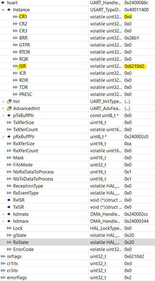

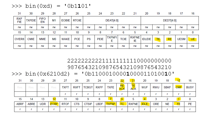

First, I have no clue why this IRQ is fired at all. In my understanding, in order to fire an UART IRQ, the appropriate enable bits must be configured in CR1-3. In this case, only in CR1 the RE, TE and UE are set.
Here is the content of CR1 and IRQ registers when the UART IRQ handler is fired:
Second, to my surprise, the HAL IRQ handler simply does nothing, no error is thrown or error callback is run. Seems to me that the frame error is only processed during receive. If no transmission is active, the frame error is ignored.
Any idea what caused the IRQ to be executed?

Is it possible that the frame error is detected and stored while EIE is disabled? And the IRQ is fired as soon as the EIE is enabled?
IMHO possible. This is why in a real life project these interrupts should not be repeatedly enabled and disabled, and receive usually should run continuously, with error handling & recovery.

what is the content of your CR3 register ? (an USART IRQ will be raised on FE flag raising, only if EIE bit is set in CR3). If not, the IRQ source might be not related to FE flag ...
Hi @Guenael Cadier ,
CR3 is 0, FE IRQ is not enabled. Here is what the debugger watch window looks like when the IRQ handler is entered and the local variables (isrflags, errorflags, ...) are read:

I think that the cause is a short spike on RX when the transfer direction is switched on the RS485 bus drivers and at the same time the TX and RX DMAs are initialized using HAL.
During DMA init the EIE bit of the UART is enabled for the RX UART and disabled for the TX UART. Seems this causes a race condition.

"Is it possible that the frame error is detected and stored while EIE is disabled? And the IRQ is fired as soon as the EIE is enabled?"
Yes if a Frame error is detected FE will go 1 independently from EIE value. And once EIE is set to 1 an interrupt is fired. In normal case, when entering IRQ handler, we should be able to see EIE still at 1 in CR3.
But, for very specific timings, explanation from @Pavel A. seems right.
