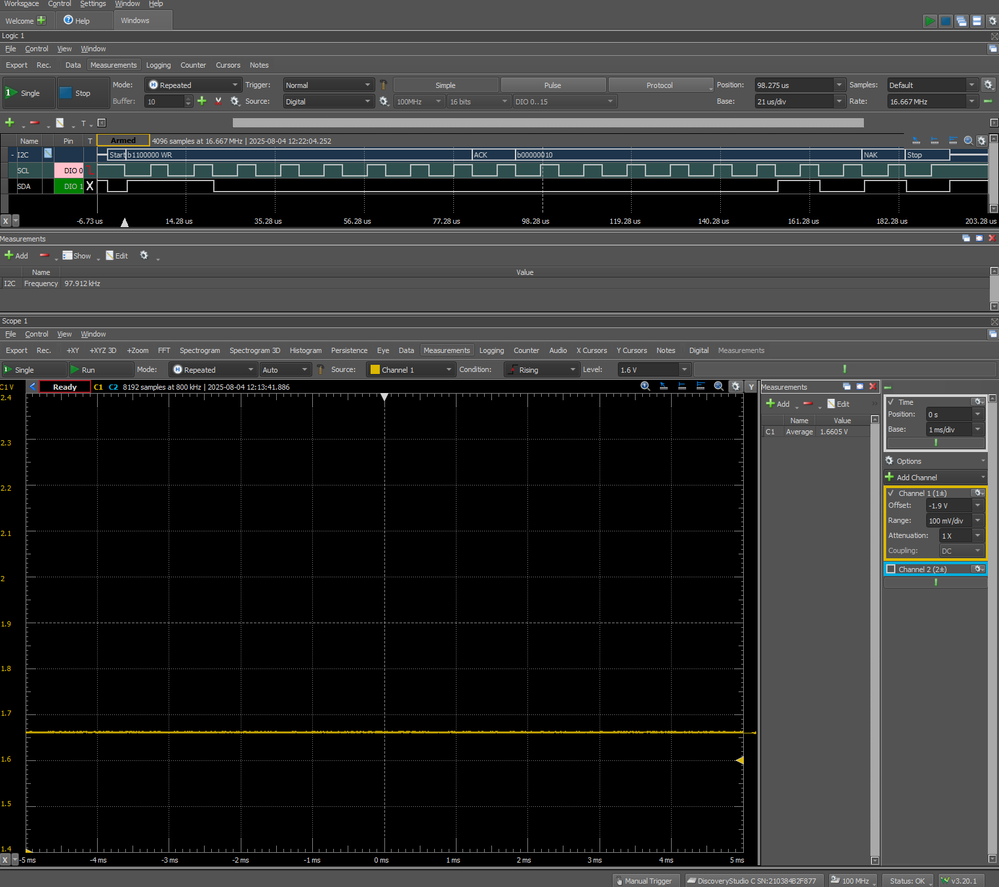

Okay I got the Logic Analyzer (LA) to give me a usable output.
However, STMCube is still reporting a HAL_ERORR.
The lower plot is the scope showing that the output of the DAC is reporting 1.6V, as opposed to the 1.3V the code is instructing it to output.
The LA does show that the 1st dataframe is correct as it is composed of the [start bit | Slave Address |  Write Bit | ACK ] but then the rest seems to fall apart.

PhillyG_SNL
The main change from not getting anything on the LA to what I am getting now was using the Nucleo's 3.3V and GND for the pull up resistors rather than the external 3.3V & GND from the Analog Discovery Studio.
Hi Bob S,
Thank you for taking a quick look. Your "channel" comment made me take a deeper look and that was indeed incorrect. I have correct that and removed the strcpy() and will be sure not to use it again. I have included a cleaned up version of my updated code.

According to the LA this code has been outputting the correct I2C write sequence for channels 0, 2, 3, & 4 but not for channel 6.
The MCP47FEB18_SetVoltage function is shown below along w/ the device address for reference:

Below are the function call, function variables, and the LA
MCP47FEB18_SetVoltage(0, 1.3);
MCP47FEB18_SetVoltage(2, 1.3);
MCP47FEB18_SetVoltage(4, 3);
Even so it does not look like it is causing the output of channel 4 to respond to the set voltages.
MCP47FEB18_SetVoltage(6, 1.3);
At this point I think that the mCU is behaving properly and I2C comms are up and running (excluding the oddity of channel 6).
On the target device side, as it is ACK'ing I want to say the I2C comms are being received correctly.
I am just not sure why it is not outputting the correct voltages.

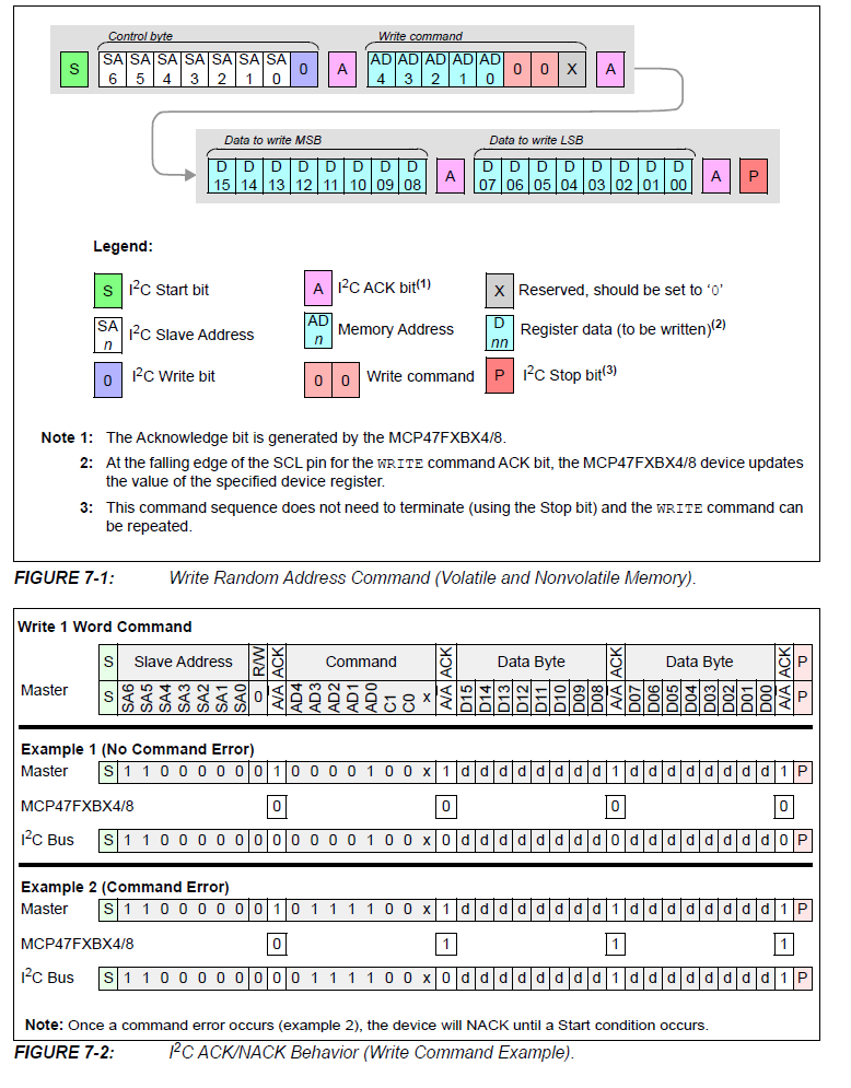

Why are you shifting the channel number by 4 bits?  Go back and look at the command format from your first post.  That will explain why the voltages are not correct and why you get a NAK for channel 6.
PhillyG_SNL
Hi Bob S,
Keen eye on the channel bit shifting.
The ACK/NACK bit tripped me up a tad for the 2nd byte.

    uint8_t command = (channel << 3) | 0x00;	// Command byte: Memory address (DAC Channel Reg) + write command (00)

Even better it looks like the Vout, even on channel 6, is now responding to all the changes!!
Thank you for slowing down my thought process and really making me look at the nitty gritty.
I tend to get excited with an idea and miss the simplest things.
Thank you again Bob S!
Glad to help.  Don't forget to mark this thread as solved.  This helps other people with similar issues find the answer.
