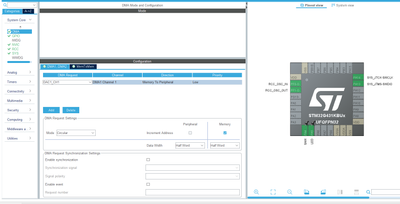

I'm working with an STM32G431KBUx and trying to output a waveform via DAC1 using DMA and TIM6 as trigger (TRGO). I’ve successfully configured the DAC and DMA using STM32CubeMX.
However, the DMA callbacks HAL_DAC_ConvCpltCallbackCh1 and HAL_DAC_ConvHalfCpltCallbackCh1 never get called.
Here’s what I’ve checked so far:
  • DMA handle is linked manually:
    hdac1.DMA_Handle1 = &hdma_dac1_ch1;
  • Trigger is set to Timer 6 Trigger Out event.
  • DMA is configured in Circular Mode.
  • I'm calling HAL_DAC_Start_DMA(...) with a buffer of 2 * 64 samples (12-bit aligned).
  • Callback functions are correctly named and defined in main.c:
void HAL_DAC_ConvHalfCpltCallbackCh1(DAC_HandleTypeDef *hdac1) {
// Never called
void HAL_DAC_ConvCpltCallbackCh1(DAC_HandleTypeDef *hdac1) {
// Never called

After reading STM32G431KB DAC DMA not working - Page 3 - STMicroelectronics Community
in the DMA setup, change Data With for the Peripheral to Word.
hth
KnarfB
4 REPLIES 4
KnarfB
You may find the raw interrupt handler in the *_it.c file which dispatches the irq to HAL. Set a breakpoint there and, if it is hit, follow the path through HAL.
hdac1.DMA_Handle1 = &hdma_dac1_ch1; is should not be needed. See __HAL_LINKDMA in HAL_DAC_MspInit.
How are the DMA settings? Maybe you add the .ioc.
hth
KnarfB
.ioc file is attached

Is the DAC working as expected? Is the NDTR register changing? Is the Timer CNT register changing? The rate of samples is pretty low. It'll take a few seconds for a half-buffer to be pushed out.
