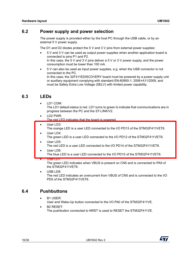

  1. PA13 and PA14 are the debug interface pins - not a good choice for timer outputs.
  2. CubeIDE-generated code soes not enable PWM outputs by default. Use TIM_PWM_Start() explicitly after timer config.
  3. In the code above, I cannot see the PWM pins being configured as AF outputs - fix it.
My STM32 stuff on github - compact USB device stack and more: https://github.com/gbm-ii/gbmUSBdevice
waclawek.jan
The LEDs indeed are not on PA12/13/14, but PD12/13/14/15.
0693W00000aJKL1QAO.pngJW
Oh, thats a mistake in my post, I do have it set to PD12, PD13 and PD14. Edited it to correct that
SG.121
1 Actually the pins have always been on PD12,13,14 - that was just a typo in my post!
