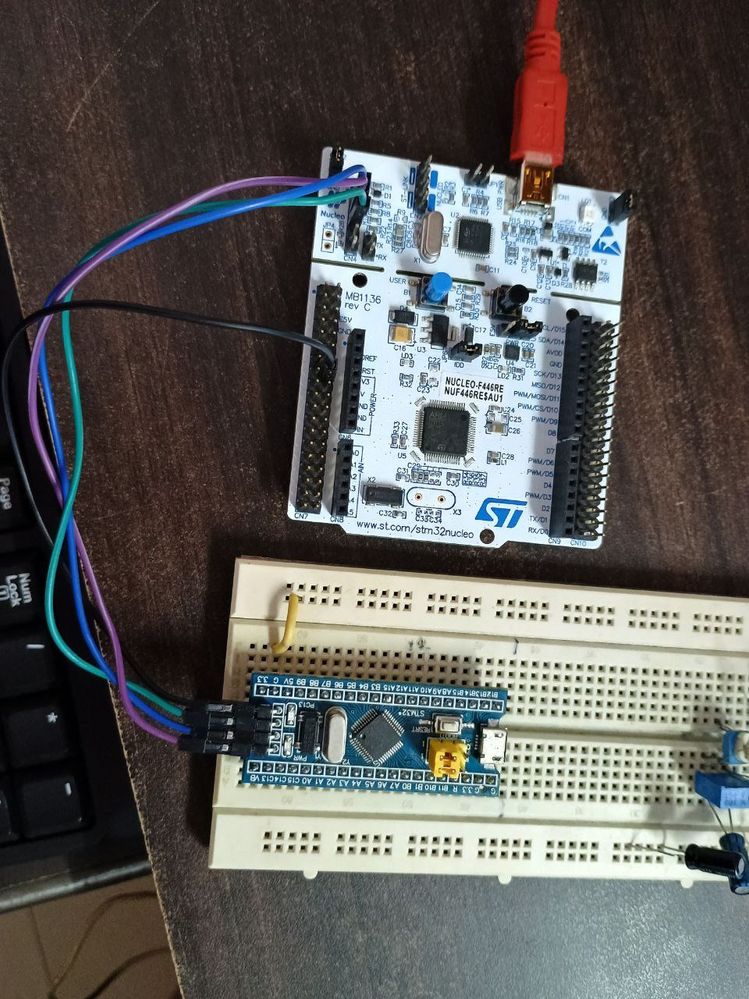

I want to debug STM32F103C8T6 controller by using the debugger present in the STM32F446RE nucleo board. After setting the parameters , when i go for debugging the following error is coming. Please guide me how i could debug my respective code using the STM32F103C8T6 controller.
Have you set all the links on the Nucleo board correctly - to disconnect the STM32F446RE Target from the ST-Link?
Post a schematic of your connections.
Post some good, clear photos of your setup.

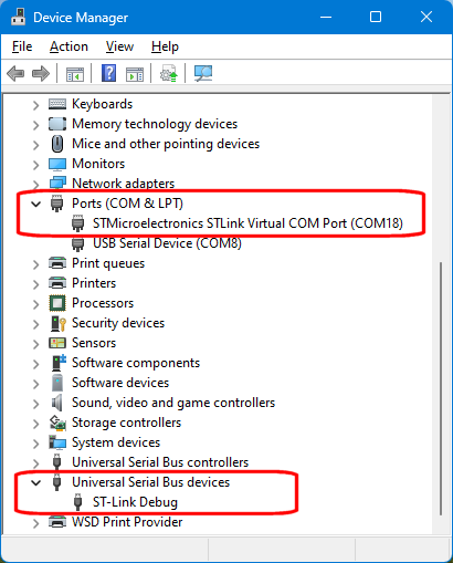

That means the computer isn't even connecting to the ST-Link.
Does it show up in the Device Manager (or equivalent)?
If not, check your cable: are you sure it's a full data cable - not jus a charging cable?

Knowledgebase article:
https://community.st.com/t5/stm32-mcus/how-to-solve-debugger-connection-issues/tac-p/698105#M956

this is the circuit connection of STM32F103C8T6 with STM32F446RE nucleo board debugger.this is the circuit connection of STM32F103C8T6 with STM32F446RE nucleo board debugger.
