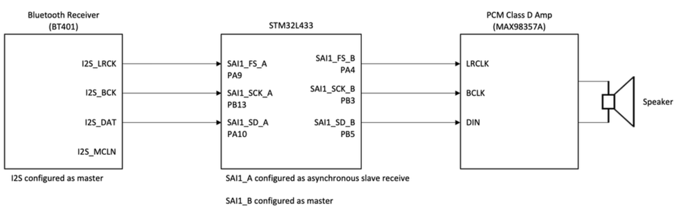

Below is the setup...
The I2S amplifier (MAX98357A) seems to work fine with the 12.288MHz clock generated by the internal MSI RC and PLL.
But the BT401 either requires multiple attempts to start playing and sometimes plays just a screeching sound for a few seconds then stops.  So I need to rule out whether the issue is caused by clock jitter by trying a more accurate clock source.

Your scoped image itle is MASTER, are you sure slave use same config. Plus you show MCLK on scope, then BT401 output it on some pin? Exist this signal in slave mode too? Or in slave mode is same pin changed to input and require MCLK from outside BT401 ? In normal audio systems all parts use one sync clock.

Its probably confusing as I am showing scope captures of when the BT401 is a master and also a slave.
The scope capture you are referring to (titled MASTER) is in fact when the BT401 was the master and the STM32 was the slave.  In this configuration, the MCLK is generated by the BT401 but is not used by the STM32 or the amp (its just captured on the scope for reference).

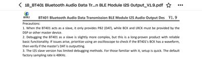

But I have since changed the configuration for the BT401 to be the slave, which is when I started having isssues with playback with the BT401. When the BT401 is in slave mode, it only ouputs data on the SD pin.  But to do this it needs a BCLK and LRCLK, which is provided by the STM32.  MCLK is not needed by the BT401 in slave mode, it only needs BCLK and LRCLK.
Yes I have already done this, I tried to feed the 12.288 MHz from the osillator into the SAI EXTCLOCK pin but it did not work.  So instead I fed it into the HSE pin and it worked, but I still had the same issues with the BT401 playback.  So I concluded that the issue is not due to clock drift/jitter of the MSI, because the issue still occurs when I use the oscillator
This is a concern and I'm now not sure whether AScha.3 solution will work, because there will be a clock from the BT401 (as a master) and a clock for the STM32 sending the audio to the amp (as a master)
If only the BT401 behaved as a slave, eveything would be working and I would not have all this grief.
I did briefly try this configuration, but the voice prompts have left over data when the finish so its broken and I need to fix it, though I am now unsure whether this configuration will actually work due to the two difference clock sources.
Show doc where is this defined.
I have also confirmed this with my contact in china who supplies the boards/chips/firmware

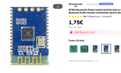

Something like this is the BT ?

I dont see one word about MCLK not required...
