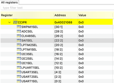

I found a clue why the SAI EXT CLOCK is not working.
I stepped through the intitilisation (SAI B is currently configured as a Tx master) and when it reaches the function RCCEx_GetSAIxPeriphCLKFreq the value for srcclk = 0 (see line 13 in the code snippet below) but I would expect it to be RCC_SAI1CLKSOURCE_PIN....
static uint32_t RCCEx_GetSAIxPeriphCLKFreq(uint32_t PeriphClk, uint32_t InputFrequency)
  uint32_t frequency = 0U;
  uint32_t srcclk = 0U;
  uint32_t pllvco, plln;    /* no init needed */
#if defined(RCC_PLLP_SUPPORT)
  uint32_t pllp = 0U;
#endif /* RCC_PLLP_SUPPORT */
  /* Handle SAIs */
  if(PeriphClk == RCC_PERIPHCLK_SAI1)
    srcclk = __HAL_RCC_GET_SAI1_SOURCE();
    if(srcclk == RCC_SAI1CLKSOURCE_PIN)
      frequency = EXTERNAL_SAI1_CLOCK_VALUE;
    /* Else, PLL clock output to check below */

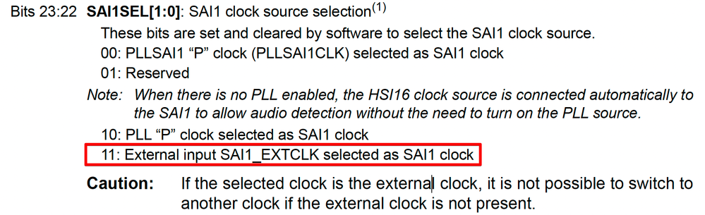

__HAL_RCC_GET_SAI1_SOURCE() reads the register RCC->CCIPR and I can see SAI1SEL is 0x0...
So why is SAI1SEL not set to '11' as shown in the refernce manual...
I've selected it CubeMX....
UPDATE:  I set a breakpoint in the function RCCEx_GetSAIxPeriphCLKFreq and manually changed the value of SAI1SEL from 0x0 to 0x3 and the SCK and FS now work and the BT audio plays.
However, the problem still exists despite using the oscillator instead of MSI.
It plays the audio from the BT401 and for ~20 seconds its fine and the next ~20 seconds it still sounds like static/stutter. This cycle repeats
And I still don't know why SAI EXT CLOCK is not being configured by the software, I only got it working by manually modifying the SAI1SEL register.

I found the reason why the SAI EXT CLOCK was not being configured.
The generated code in the file stm32l4xx_hal_msp.c configures all the periperhal clocks.
When initialising each peripheral, the clock selection is defined by PeriphClkInit.PeriphClockSelection.
But for some reason, when initialising the SAI peripheral (HAL_SAI_MspIni) there is no value assigned to PeriphClkInit.PeriphClockSelection
A value is assigned to PeriphClkInit.Sai1ClockSelection (RCC_SAI1CLKSOURCE_PIN) but because PeriphClkInit.PeriphClockSelection is zero the SAI clock peripheral never gets configured
So I manually added the line (for SAI block B)...
PeriphClkInit.PeriphClockSelection = RCC_PERIPHCLK_SAI1;
So is this a bug ?  All other periphals (e.g. USB, UART, I2C etc) are assigned with a value for PeriphClkInit.PeriphClockSelection with the exception of the SAI.
