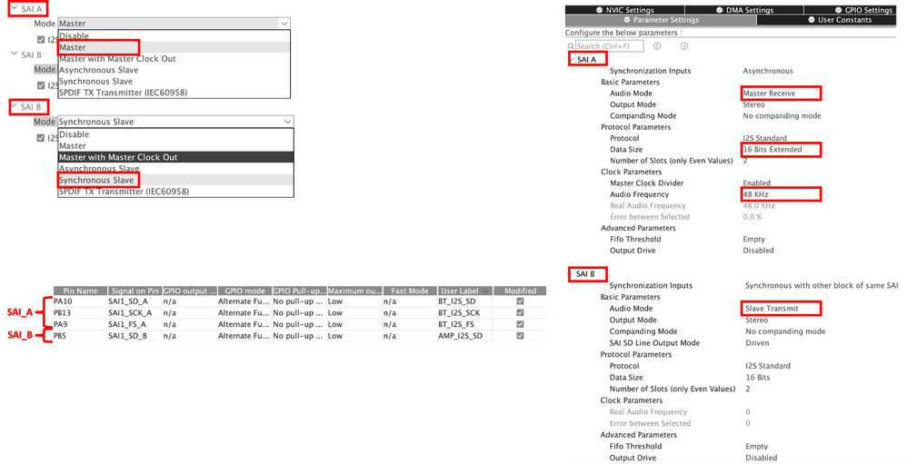

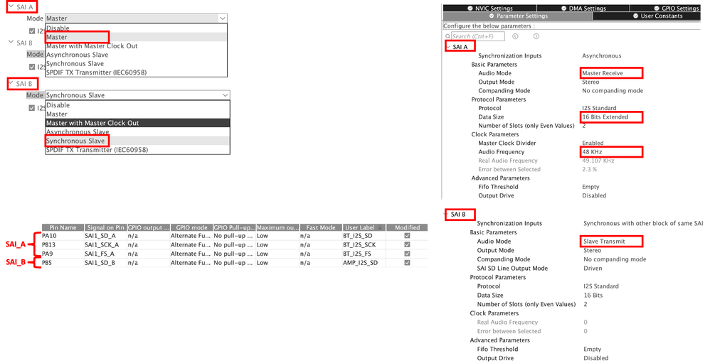

  • BT401 is I2S slave
  • STM32 SAI A is I2S master receive
  • STM32 SAI B is I2S slave transmitt
  • STM32 clock is MSI RC 12.288MHz
Below is the SAI configuration...
The BT401 doesn't just play corrupted noise or refuse to play, it also looses the bluetooth connection.
After multiple attempts at trying to play audio through the BT401, the bluetooth connection is lost to the BT401 device. The status LED on the BT401 turns off, then starts flashing (indicating its waiting for a bluetooth connection)
I have to remove the BT401 device from the phone as it refuses to connect, perform a power reset of the BT401, then add the BT401 device on the phone again.
So its not just a playback issue, its also the bluetooth connection issue which happens when attempting to play audio throught the BT401.

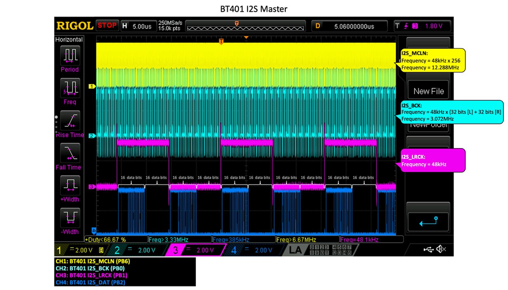

Yet if I configure the BT401 to be the I2S master and the STM32 to be the I2S slave, it works correctly, but this is not the ideal setup as previously mentioned.

Eveyrthing works correctly when the BT is master and the STM32 is slave, I've already got that working without any problems.
But I would prefer to use the BT as slave and the STM32 as master, but the BT401 does not behave when it is the slave.
I was hoping it was due to clock drift due to using the MSI RC oscillator on the STM32, but when I tried using the external 12.288MHz oscillator instead of the MSI RC oscillator the BT401 still did not behave

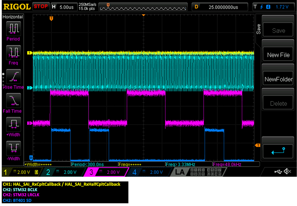

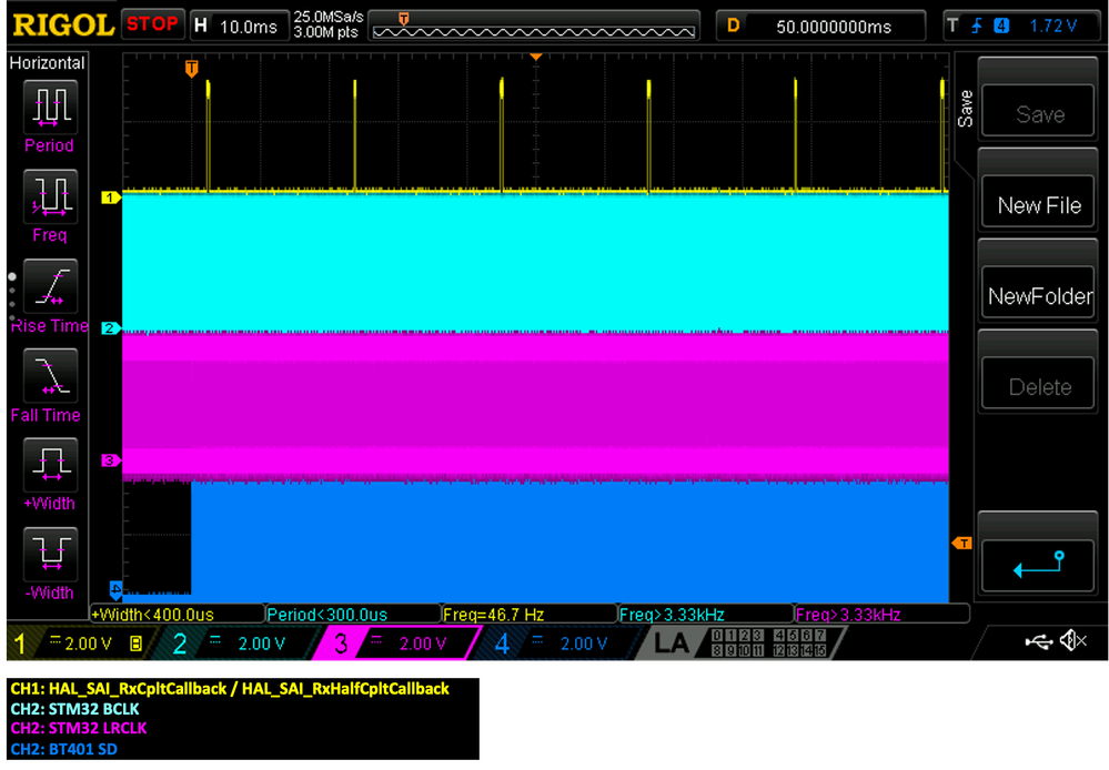

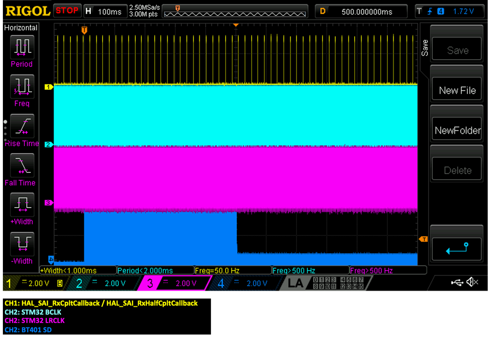

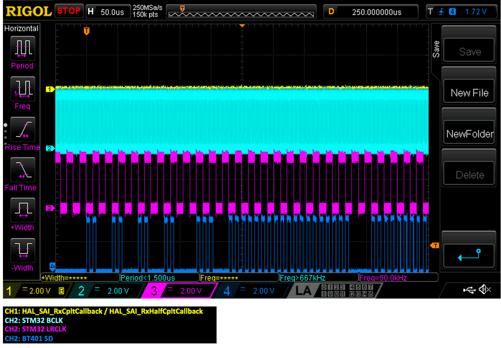

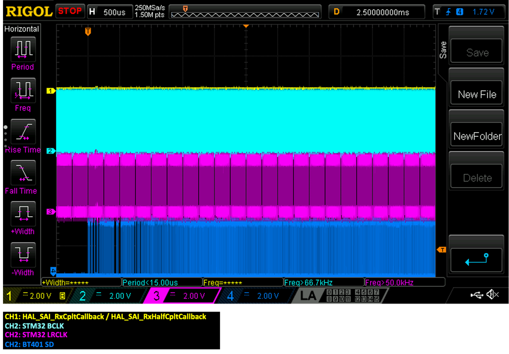

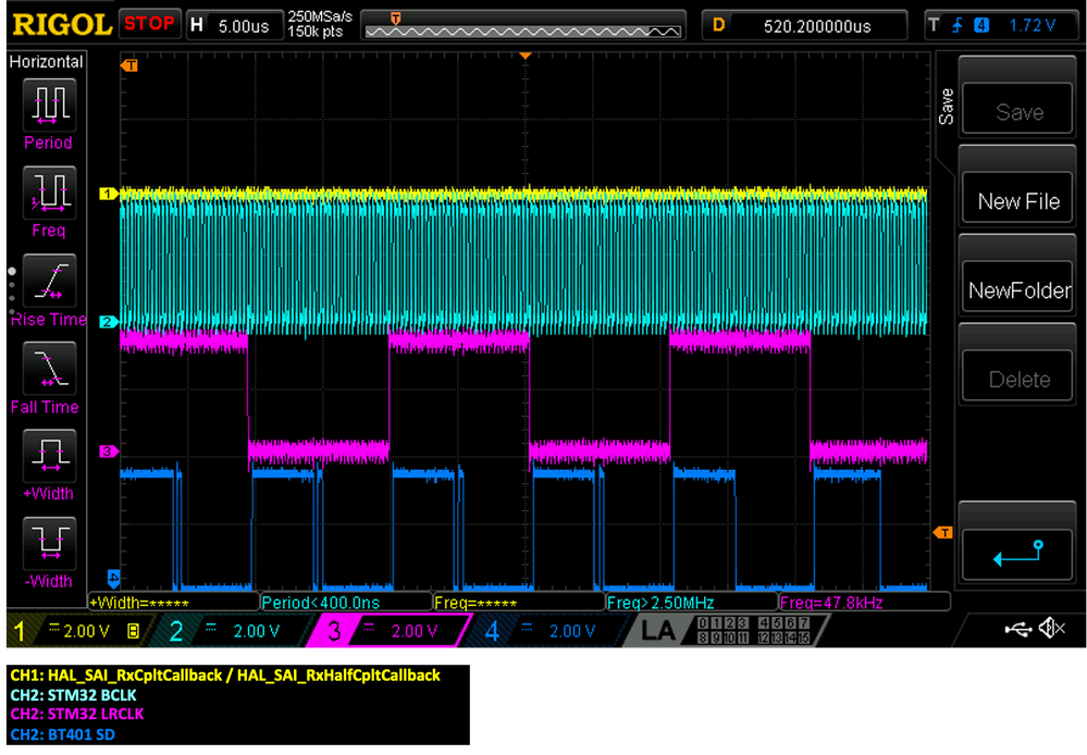

I have attached some scope captures when the BT401 is slave and the STM32 is master, but I don’t think it tells you much ?
The scope was set to a single trigger on the rising edge of the BT401 SD output (CH4) i.e. when audio is intially played from the phone.
The BCLK and LRCLK generated by the STM32 are on CH 2 and CH3 respectively.
CH1 is set for the duration of the I2S DMA interrupts (HAL_SAI_RxCpltCallback & HAL_SAI_RxHalfCpltCallback).
The BT401 should output data when the phone plays the audio so long as it has the bit clock and left/right clock from the STM32.  Even iif the data output pin (SD) was not connected to anything, you should still see data out.
But as you can see from the scope captures, the initial data is corrupt and after a very short time the data just stops (as shown in the last scope capture when it stops after ~500ms).  After several attempts of trying to play, the BT401 seems to reset all its settings because the bluetooth connection is lost and it has to be removed from the phone and added again (this also requires a power reset of the BT401).
So the issue is to do with the BT401, but I don't know what the issue is.  Its not due to clock drift as I already proved that by using an oscillator. The STM32 firmware is working correctly, its just that the BT401 does not behave when its in slave mode.

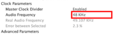

Hi , some hints 1. module irelevant slave or master use own clk .
2. you have fails in config start with here
audio systems never will work with 2,3% error in clk.
3. Your cyan scoped BCLK seems clock 24 bit instead 16 , that require BT401
4. Using HAL and MX for this isnt optimal way, sometimes impossible. As you see with not working ext clk.
After you correct mistakes i mean slave can work as you plan.

Is this what the configuraton would look like....
At the moment I only use the receive callbacks (HAL_SAI_RxCpltCallback & HAL_SAI_RxHalfCpltCallback) as shown in the code I posted.
With this alternative configuration, would I need to use the transmit callbacks too ?
Apologies, that screnshot I posted was an older version which had the incorrect clock configuration so the SAI showed an error with the 48kHz audio frequency as you pointed out.
Since managing to achieve 12.288MHz for the SAI clock, the audio clock is now correct with no error....
The BT401 uses 32-bit data frame but only sends 16-bit date...
The BT401 outputs 16-bit audio data packaged in a 32-bit I2S frame format. The BCK frequency of 3.072 MHz (48 kHz × 64 bits per frame) confirms this 32-bit-per-channel transmission structure.

The receive callbacks...forget , for now. BT receive will run , but we dont use it.
Except, later, if it looks "ok" , then we copy in the (transmit) callbacks not zeros for silence, or "voice" for info, but also then one of the input buffers , to "copy" the input from BT to the play buffer.
(Synchronisation is at first not important, we do it later. Get it working at first, even if BT audio might have some dropouts...or else, not important now. )
We create two independent streams : the important, L433 is master, to play to the dac.
The second, from BT , might run...musik, or not...silence. But output always possible, and voice clear.
