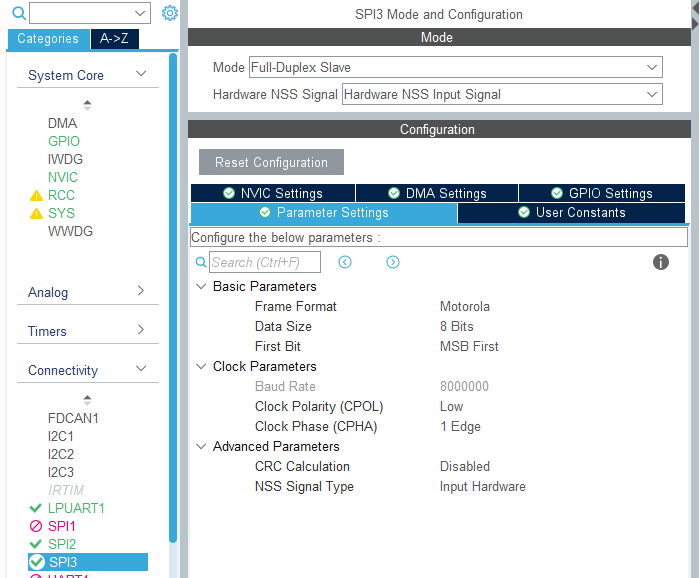

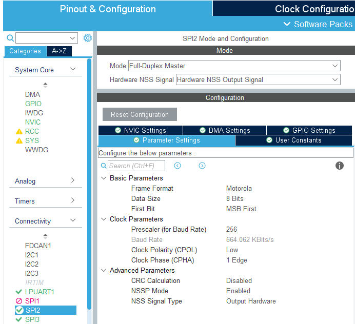

SPI2 settings

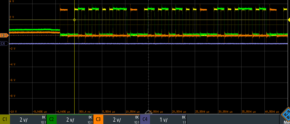

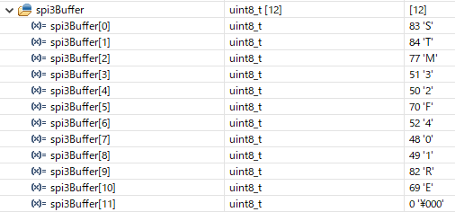

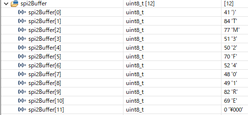

 result when sent from SPI2

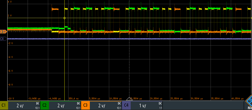

0693W00000bhGbHQAU.png result when sent from SPI3
0693W00000bhGcKQAU.png0693W00000bhGcVQAU.png0693W00000bhGfJQAU.png result when sent from SPI2
orange: NSS
yellow: Clock
green: MOSI
0693W00000bhGfdQAE.png result when sent from SPI3
green: MISO0693W00000bhGfnQAE.png

Try this:
 memset( spi2Buffer, 0x00, sizeof(uint8_t) *12 );
 memset( spi3Buffer, 0x00, sizeof(uint8_t) *12 );
 sprintf( (char *)spi3Buffer, "STM32F401RE" );
 HAL_SPI_Transmit_IT(&hspi3, spi3Buffer, strlen((char const *) spi3Buffer));
 HAL_SPI_Receive_IT(&hspi2, spi2Buffer, strlen((char const *) spi3Buffer));
ie. start slave Tx *before* master's Rx.

TKawa.9
Thank you for your help.
I made the changes as advised by waclawek.jan and it solved the problem.
It worked fine.
Thank you very much.
